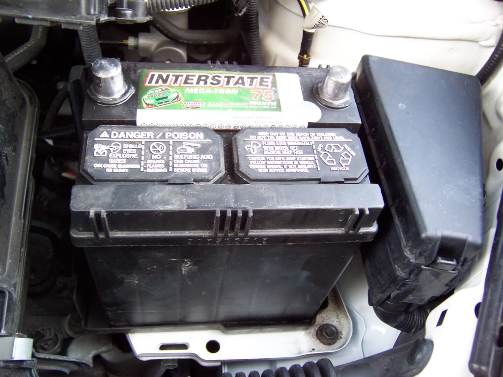

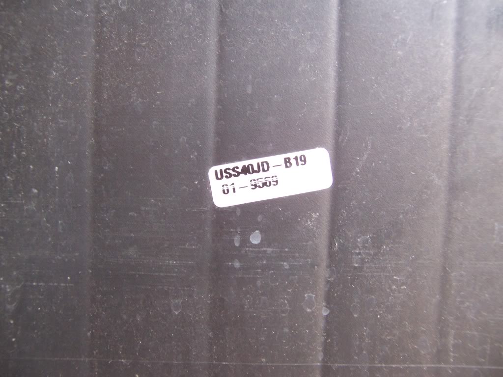

Hi Will, here are the pictures of my Interstate battery. The case measures roughly 8" high (8.75" including terminals), length 7", and width 4.75" . Hope this helps.

This is the only other sticker on the battery:

Old Nov 29, 2010 | 06:59 PM
john380's Avatar
Joined: Jan 2010
Posts: 121
From: Upstate, NY
Old Nov 29, 2010 | 07:54 PM
john380's Avatar
Joined: Jan 2010
Posts: 121
From: Upstate, NY
All tucked in:

John, Thanks for taking the pics for me. I'm puzzled though cause Interstate doesn't list a battery for the fit. Time to do some more checking.
Thanks
Old Nov 30, 2010 | 03:44 PM
willy65000's Avatar
Joined: Aug 2006
Posts: 311
From: Minneapolis, Minnesota
I just called customer service at Interstate Battery and they have no listing for a battery for the fit.
