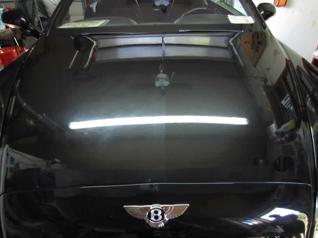

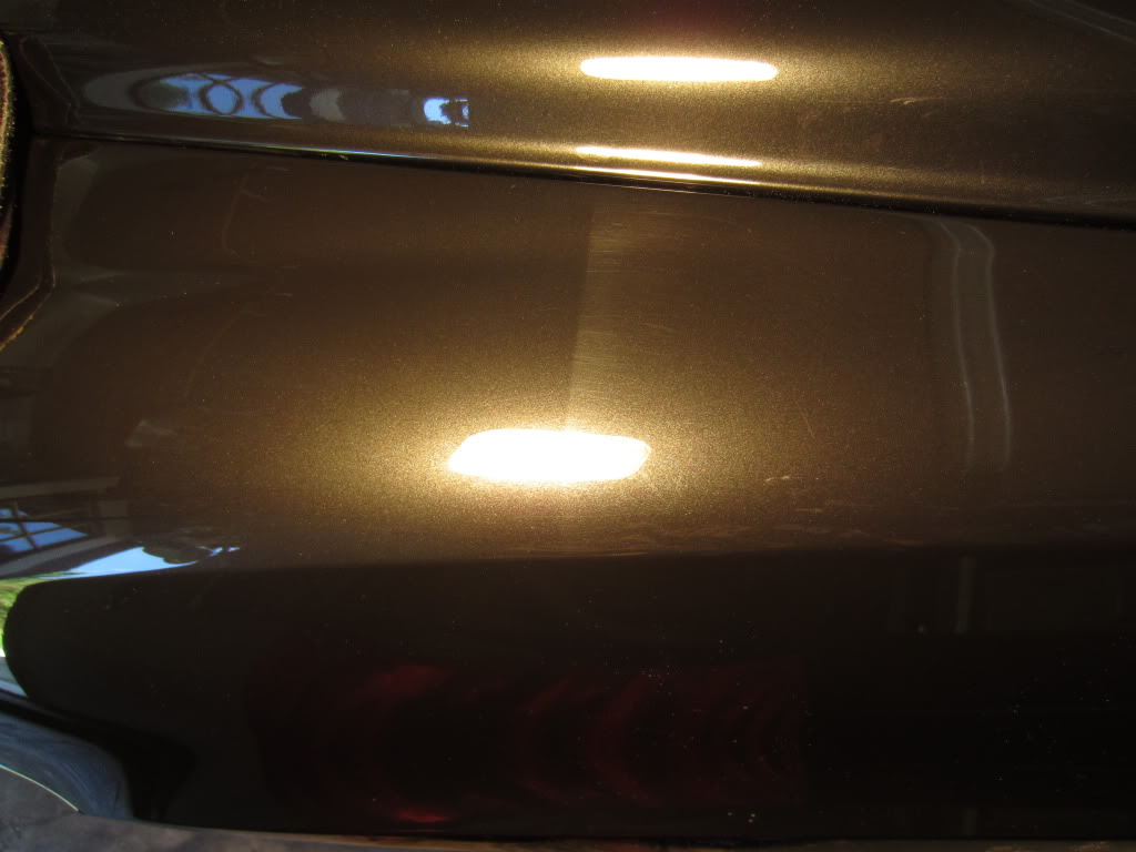

Here are some examples of polishing outcomes:
Left side of this Bentley panel has been restored, but the right side has not.
Another example, but the left side of the hood has not been restores, and the right side has:

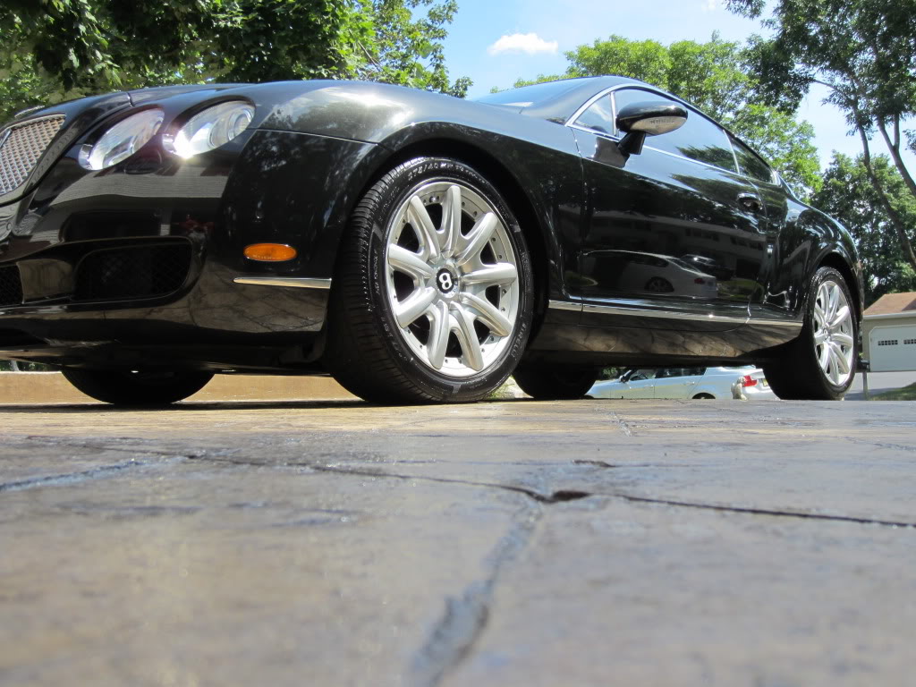

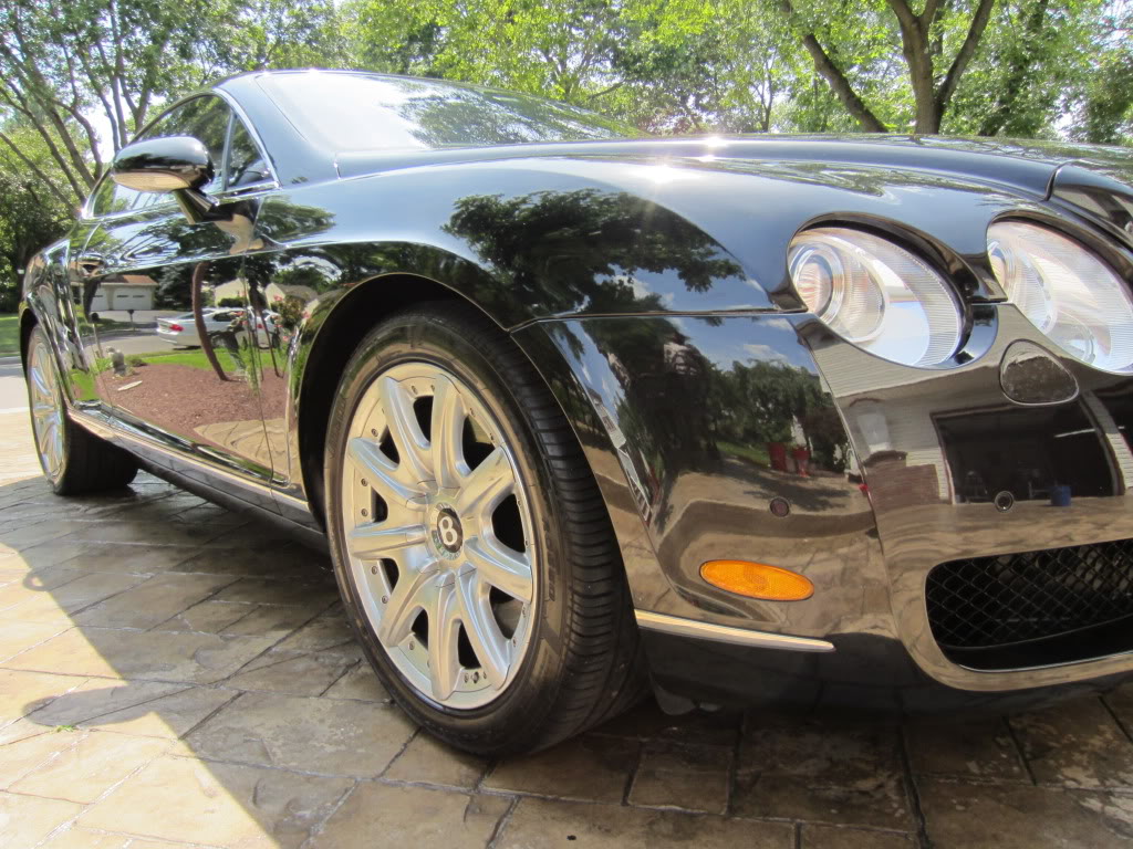

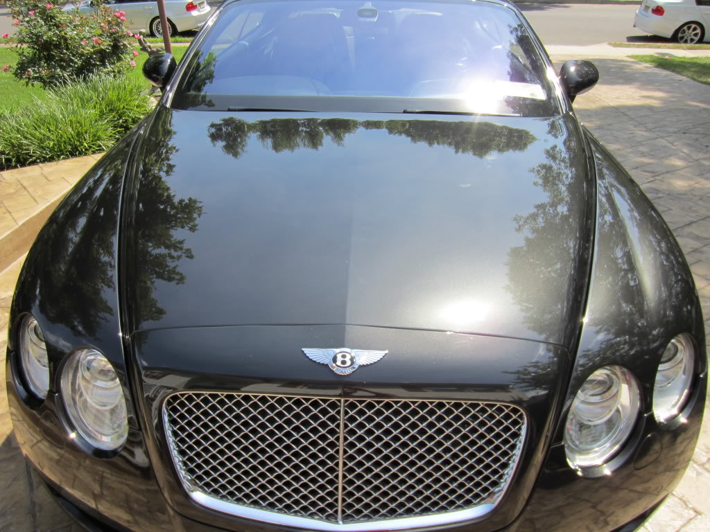

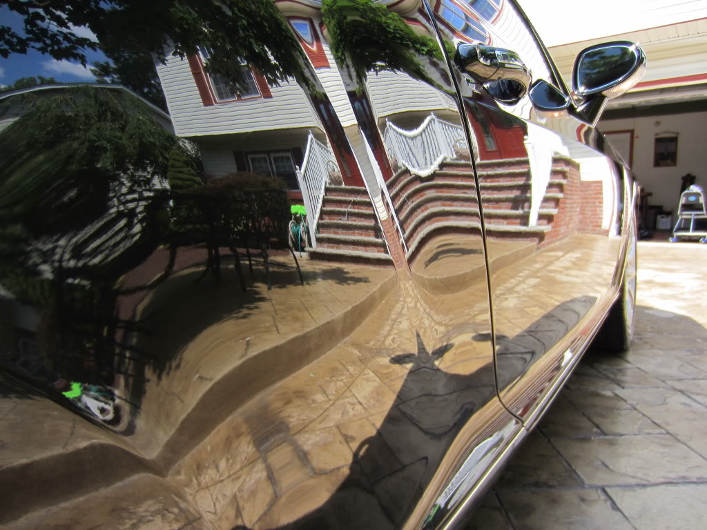

AFTER the ENTIRE car was polish using a three stage process:
Menzerna Power Gloss (Compound)
Menzerna Power Finish ( Less Abrasive polish)
Menzerna Super Finish ( Micro Abrasive polish)
Menzera Power Lock ( Paint Sealant)
Auto Finesse Passion ( High Quality European Wax)
