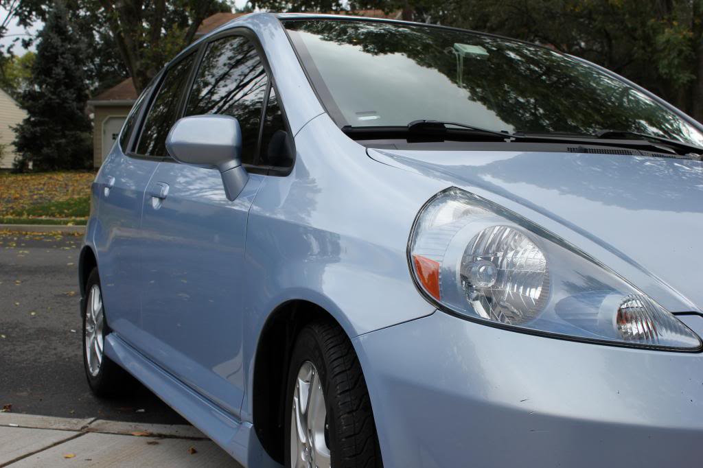

Hello Everyone,
Here is a 2008 Honda Fit I performed a single stage correction and a thorough interior detail on.
Products:
Menzerna Power Finish
LC CCS Orange Pads
Collinite 845
Before the car was delicately hand washed
After the Vehicle was hand washed, polished and waxed:
Feel free to ask questions

what DA did you use?
which brand menzerna PF2500? Megs 205? sonax?
Did you clay before polish?
DEcon? tar etc?
what LSP did you use?

I used a Rupes LHR 12e duetto, and I used Menzerna SF4000, which is a micro abrasive polish. Additionally, I always apply a ferrous particle remove to the paint, so the chemical claybar will remove the embedded iron contaminants. I also manual claybar the surface to shave down the contaminants which have pierced the clear. Always decontaminate the surface before polishing. I sealed the paint with menzerna colorlock.
