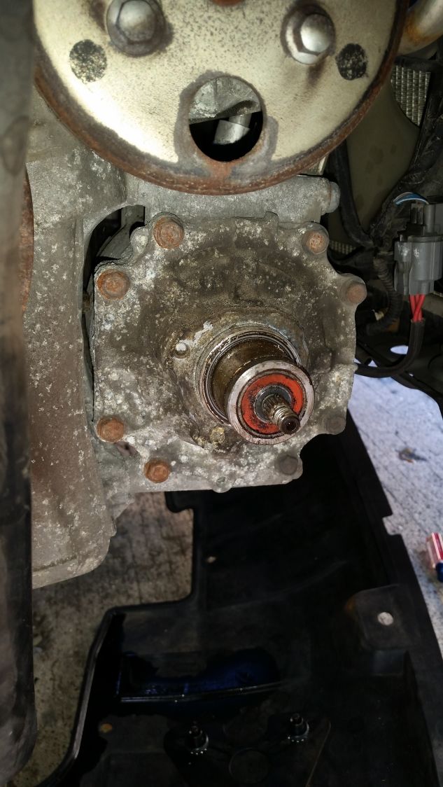

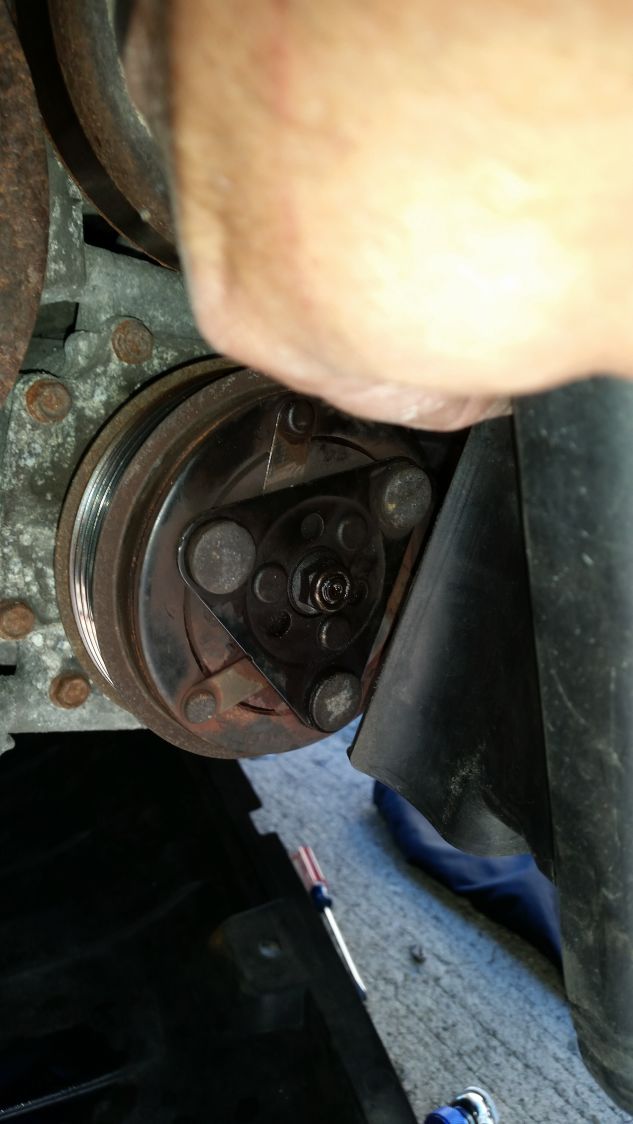

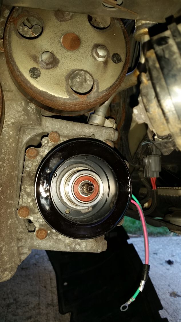

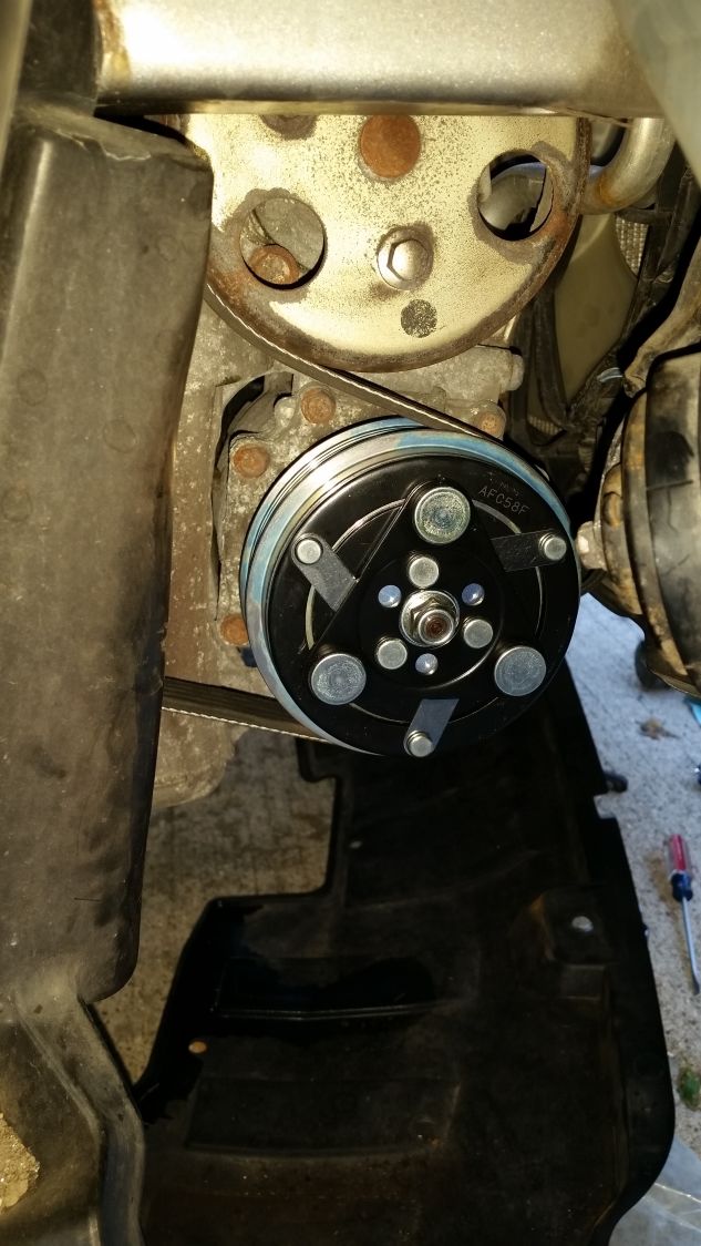

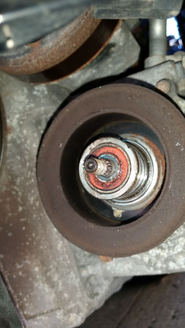

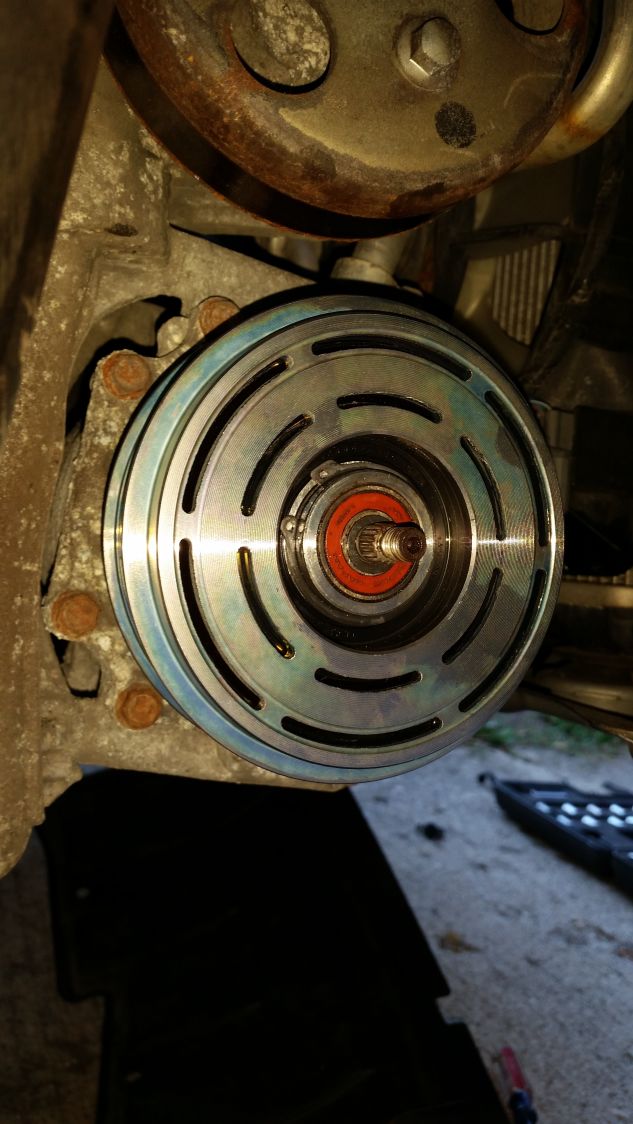

Okay, here are the pictures and run down. The biggest pain in the butt was getting the screw out that holds the cable for the coil. I had to use Vise-Grips to get it out. Luckily, there is a new screw and clip provided with the coil. Second pain was, my snap ring pliers were only big enough for the pulley snap ring so I had to wait around until my wife got home so I could run to Lowe's to get a bigger set. After that, it went pretty smoothly until time to put the new drive belt on. When I replaced my alternator a while back, I went with a higher output one. It had a small pulley so the belt I have been running was a bit too big. I had used up all my adjustment and would squeal from time to time so I went with the next size smaller. I managed to get it on and adjusted now it is quiet once again and I have A/C.
Old clutch before removal.
Pulley removed, old coil.
Coil removed.
New coil installed.
New pulley installed.
Belt back in place and ready to test.
Attached Thumbnails Is this Coil Pack/Valve Adjustment or a Transmission Rattle?-80-2016_10_08_15_27_40_1de9eec5be3e7ac15f29ac74b84aebbafc16e9fb.jpg   Is this Coil Pack/Valve Adjustment or a Transmission Rattle?-80-2016_10_08_15_37_07_d9a5853d9437b44c5bc48b95c682307e7693cf31.jpg   Is this Coil Pack/Valve Adjustment or a Transmission Rattle?-80-2016_10_08_15_50_29_0aae751206f149ff4c834855e2183d90838f91e6.jpg   Is this Coil Pack/Valve Adjustment or a Transmission Rattle?-80-2016_10_08_16_49_46_7657ddd7d10c38ce6fc4f618e116dd6305460a49.jpg   Is this Coil Pack/Valve Adjustment or a Transmission Rattle?-80-2016_10_08_17_06_52_c174e823bd3c3226cd010fe2f4ac5acbf90c8664.jpg
