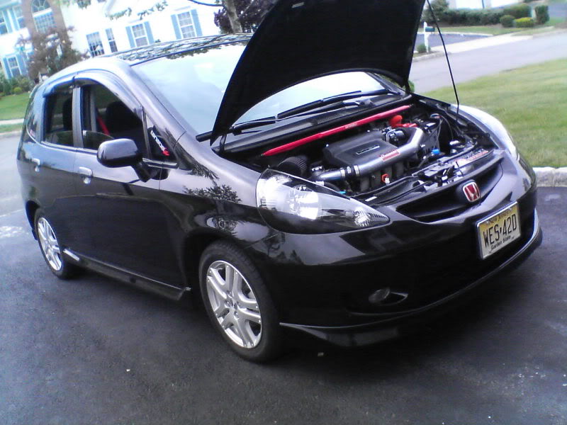

My installation, although tedious, went thru without a hitch. It was just me and a friend, in my garage, all weekend long. But all in all, this thing is TIME AND MONEY WELL SPENT. GREAT NOW I CANT GET CAPS LOCK OFF... HOLD ON A MINUTE LMAO... Thats better... stupid computers lol...
Anyway, the kit is amazing, the gains are undeniable, although i must say, im definitely getting the hondata reflash when its available... this is like the only pic i have at the time since i left my memory card in my car lol>>>
So sorry i gotta run, im not gonna be on that often, just wanted everyone to know how awesome this thing is... thanks 4 ALL your help Brian and Oscar... anybody can feel free to pm me, it might just take a while for me to respond lol.... gotta run, PEACE GUYS!!!
