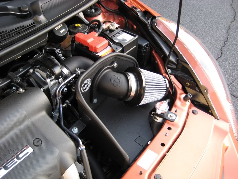

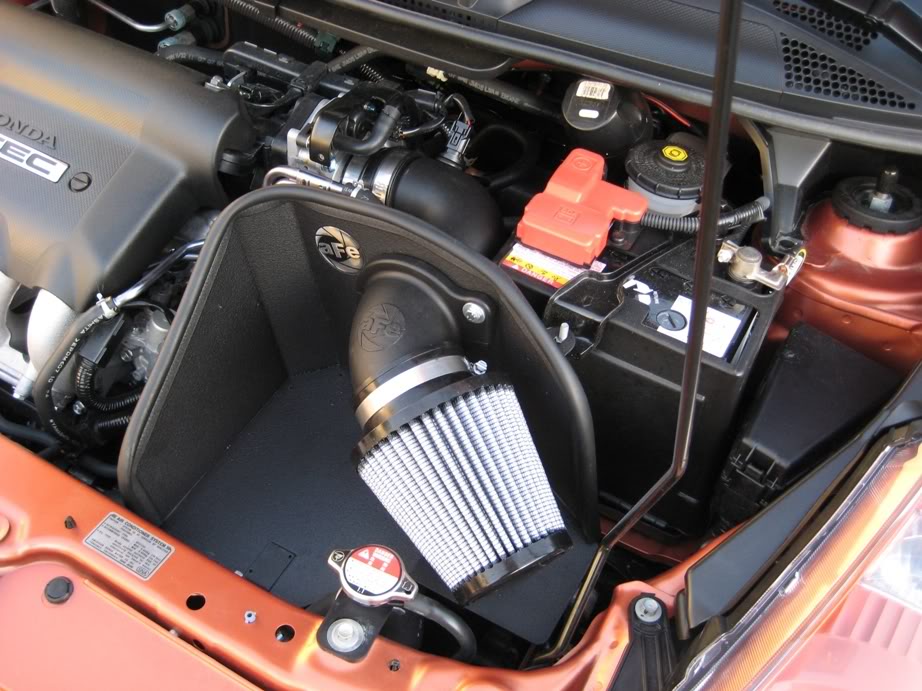

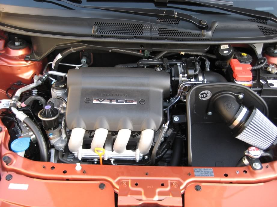

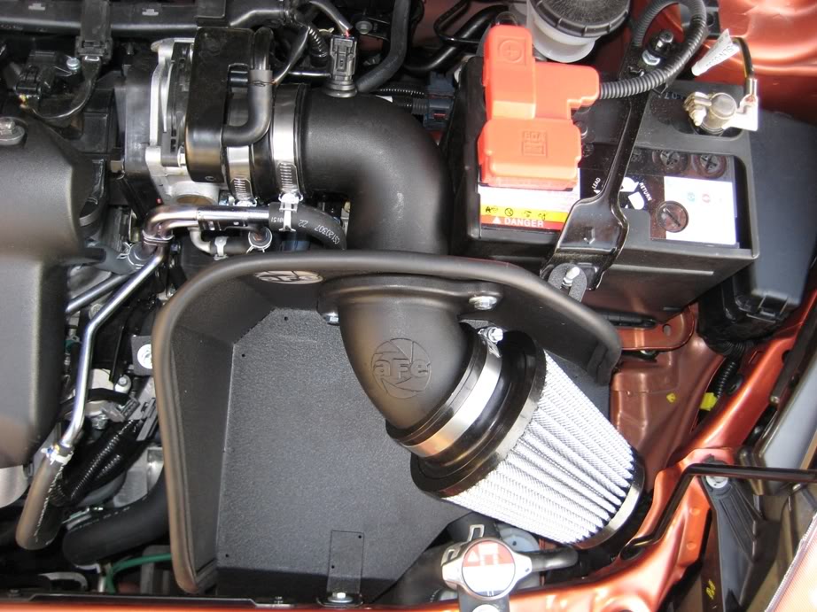

Just put it in tonite. Only drove very little after so can't comment on how it performs yet. Things didnt line up perfect, but was able to push and pull to get it in. I also slit open some fuel line and put it over the end of the sheild right at the rad hose to avoid any issues there. I went with the dry flow filter. Its washable, but no messy oil to have to deal with.

I like the look and the materials used in this intake. One big question--- am I correct in thinking that you can't check coolant level in the overflow tank, or add coolant when low, or check AT trans fluid level with the dip stick, or add AT fluid when low, all because the intake heat shield is directly in the way?

Hmm good question, I dont even know where to tranny dipstick is, or the coolant overflow. I'll have to take a look for those now. When this was going in it didnt seem to cover anything that the stock airbox didn't, as far as I know. I'll take a look under the hood and report back.

Thanks for checking Rod. In your photos, it appears that the front side of the heat shield attaches to, or rests against, the back side of the radiator support. The coolant tank is directly under the shield, and so is the trans. dip stick. With the stock air box in place, there is just enough room between the radiator support and the air box/intake tube to see and fill the coolant tank, and with difficulty, reach the trans. dip stick.

Well you were right, the tranny dipstick is definitely not accesible. I am thinking maybe cutting off part of the corner of the shield under the filter to be able to squeeze an arm in there. The overflow tank is somewhat accesible, but cutting that corner off would make it even easier to get to.

That's pretty much what I thought from your good photos. My interest is high because of the poor or non-existent heat shields on all of the other SRI intakes, including the bad design of the K&N currently on my own AT Sport BOM.

Your AFE intake offers several design improvements over the other SRI systems. The heat shield is very well designed, and the filter is low enough so that water leaking in past the hood weather strip probably won't soak it. The unfortunate part of your system's design is the fact that you can't reach the trans. dip stick or add fluid. If you cut off the corner of the heat shield bottom panel, that should give you enough clearance to reach everything you need. Be sure to file the cut edge to blunt it so it won't slit your wrist when you reach past it for maintenance tasks.
I also suggest that you buy a sheet of 1/16" thick silicone rubber at your local ACE hardware store (plumbing dept.). If you rivet a piece of the silicone sheet to the bottom of the heat shield, it will replace the function of the metal piece that you cut off and will keep hot air from rising up into the filter. When you have to reach back for the dip stick, the rubber will just fold out of the way.
