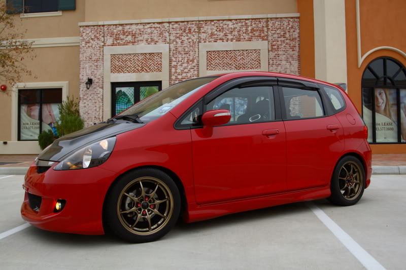

well i just ran into a issue on the LAST FREAKING thing to install. the charge pipe that goes over to throttle body does not clear on a jdm car. wonderful. theres no way im cutting up a 2000 dollar hood either so its either custom charge pipe, or take the kit off. wow, no fun.

pics of the jdm fit! lol
umm.. custom pipe shouldnt be that bad.

well its bad bc we dont have a car to drive right now .... its been posted here before, its a usdm fit with full mugen conversion
