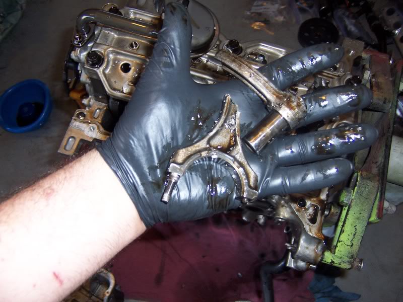

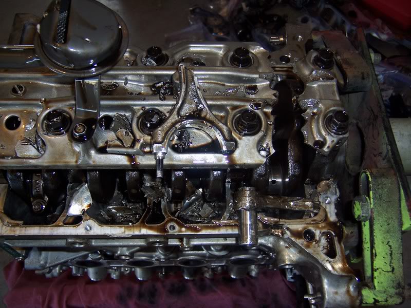

t1r is same turbo as hks t25 journal bearing. t28 is the turbo i need to make 300, the t25 is only good for 220. i know this cuz my hks turbo is ALL THE WAY turned up and we could only yeld power of 220, on a side note my stock rods let go on a detonation at 10lbs, looked like taffy
Size:  81.9 KBName:  100_8147.jpg

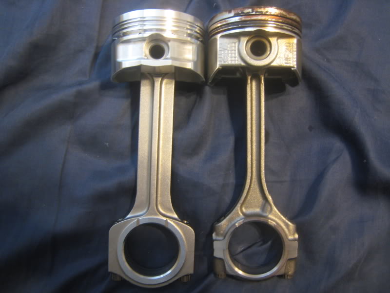

now look what the correct rod for the job looks like,
