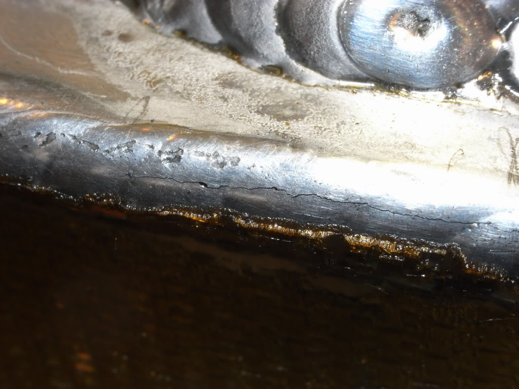

after 5 months of BEATING ...my WR intake manifold finally cracked !!
i didn't take it apart yet but there are oil coming out of the welds and i have no vacuum....."what else could that be.....duh !"

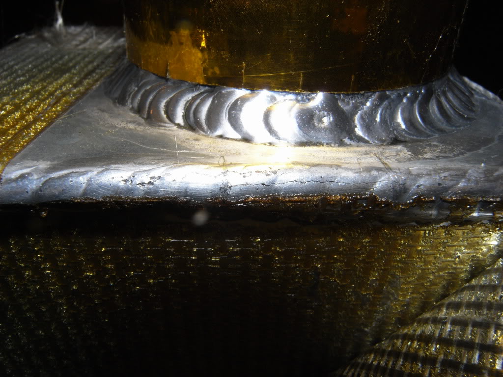

the pic u all been waiting for !!!!

That is ugly looking....I guess that they call them racing manifolds so the can deny responsibility for poor workmanship when the damned things start self destructing..... They appear to make good power though.

ugly, horrible design, horrible company but! they make power.

Can it be fixed to where it will stay together? ....The pictures posted show welds that look like they were done by the worst student in my 7Th grade metal shop class almost 50 years ago.

well it is made by weapon r-tard

yeah my WR intake has some BAD welds.

ship to me and i can repair this no problem. they needed in add on a gusset to the intake piping cause that is where it is all cracking.

the real problem is the welding fitment of the aluminum plating. i have seen these problems before on the boats i have worked on. they dont leave a corner to corner so they can add welding material and rather just seal it up so it wont leak but the vibrations are what kill the weld and form cracking.
i think it is how it's made causing it to crack....
the weld is just sh*t !

you got it. just get someone who knows how to weld to fix it and add a little bracing and it will be good to go.

Sorry i havent chimed in sooner.. I didnt see this post.. But if there is anything we can do we will fix this manifold... We did have some problems with earlier batches with some bad aluminum material.. But we have since recalled those and disposed of those bad manifolds.. If you have one that cracked we will replace it with no questions asked..
You can email or PM me and i can let you know how to replace your manifold.. If anyone else has a problem like this we can replace it..
