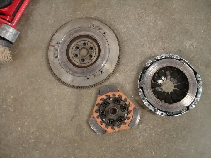

Exedy Clutch is out. It ate up my flywheel with deep grooves.

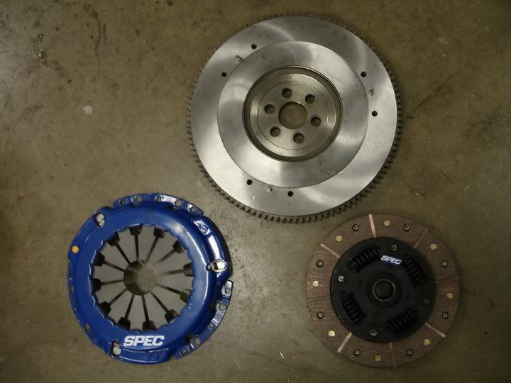

Spec clutch and Exedy clutch side by side. Never ever getting a 3 puck again!

Spec clutch with resurfaced flywheel.

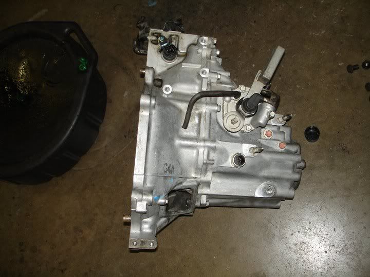

Cleaned up the tranny while it was out. It was filthy.

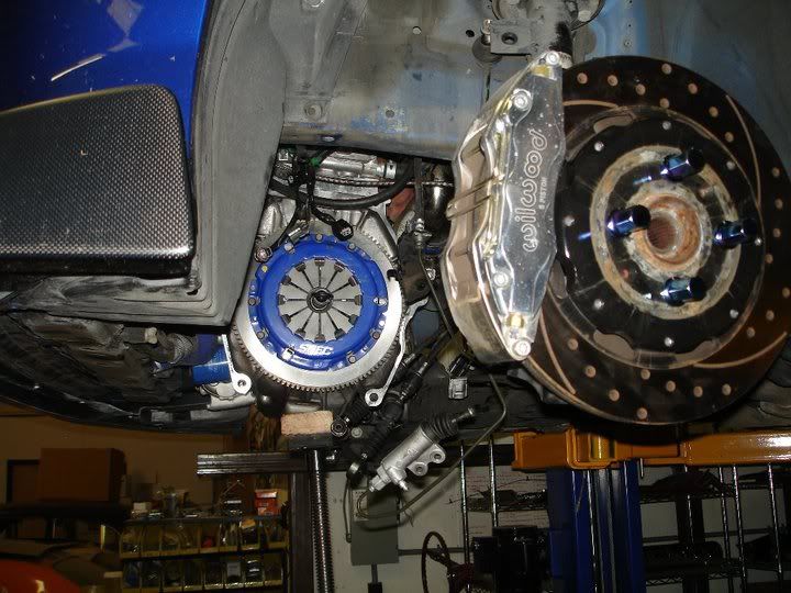

Flywheel is mounted. Nice and shiny.
Spec Clutch Stage 3 is in!

Thanks for the positive review. I noticed a few statements and questions that needed answering so I thought I would join the discussion. I hope no one minds!
Engagement Point:
There seems to be some confusion about engagement point. As a clutch wears the diaphragm fingers raise which means that the engagement point will also raise. You have likely noticed that when you have a clutch that is worn out that the travel required to release and engage the clutch is reduced (occurring at the top of the pedal). When you install a new clutch the fingers are lower which means that the point of actuation will be lower too.
Stage 3+ Disc:
Stage 3+ is considered to be full-faced. The relief-slots cut into the surface are there to aide in de-gassing (associated with heat) and the elimination of dust from the surface. This disc is the smoothest engaging, high capacity options, available! It is truly fantastic to drive...
Clamp-Load:
Clamp-load is only part of the equation when it comes to clutch performance and capacity. Friction coefficient and swept area are also part of the equation. We normally have ratings for our kits on the site but for some reason the Kit units are not listing torque output. I will run the numbers and post them ASAP.
Pedal-Effort (effort for actuation):
As for the reference to our kits having light effort, this is relative to way the plate is built. Increased pedal effort does not equate to higher clamp-load. Ultimately effort is relative to the way that the pivot/fulcrum is modified and there are ways to increase clamp without adding to the effort required for actuation. This is something that we have become quite good at and something relative to our methods! It's a lot like the colonel's secret recipe...I'd tell you more but, if I did, I'd have to kill you!
Rebuild-ability:
As for rebuild-ability, this is relative to the kit and the options selected. Often times discs can be relined, and of course flywheels can be resurfaced, but in most instances the plate will need to be replaced after usage. This is relative to the amount of wear present and the subsequent machining of this surface and its affect on geometry. That being said, in most instances, the pressure-plate (the part that is blue and the components inside the cover) will need to be replaced.
I hope this info helps. Let me know if you have any further questions and I will be happy to assist you! Thanks!
