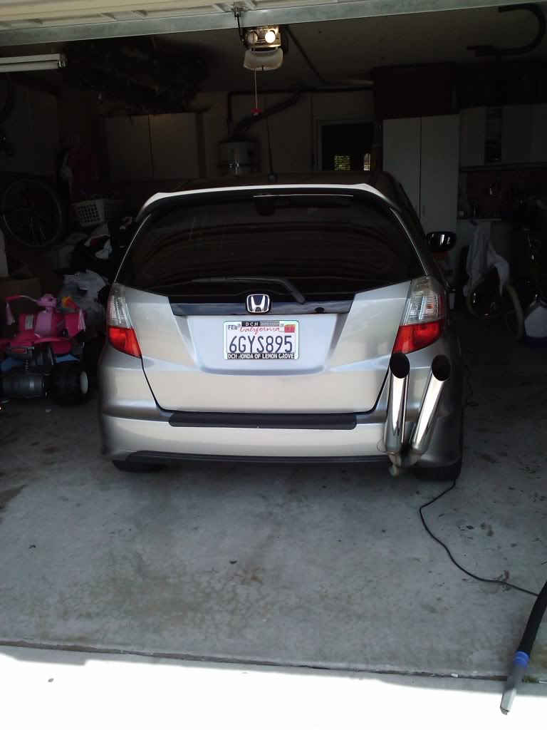

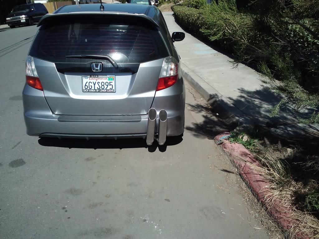

no header if u want low tone and not go deaf. just get a catback ull be happy. i run no muffler and i sound like a street bike but i like hks/megan/apexi ect. mufflers those will also sound good. but i have a theory- cant get air in, if u cant get it out... but if u cant get air out, if u cant get air in so i belive an intake and exhaust together will show more improvements then just one or the other. dont spend 400+ for exhaust i get it custom made in sd for 145$ any piping i want with whatever route (over/ under axle/ cut outs ect.) u just need a muffler. i wouldnt spend 200+ on those but i can get a hks style muffler (almost the same size too/ they are fucking huge btw) for 40 from a local shop. so honestly my cheapest exhaust w/ muffler would be 200? or just about but since i dont want a muffler i had the most wonderful exhaust tip made...
