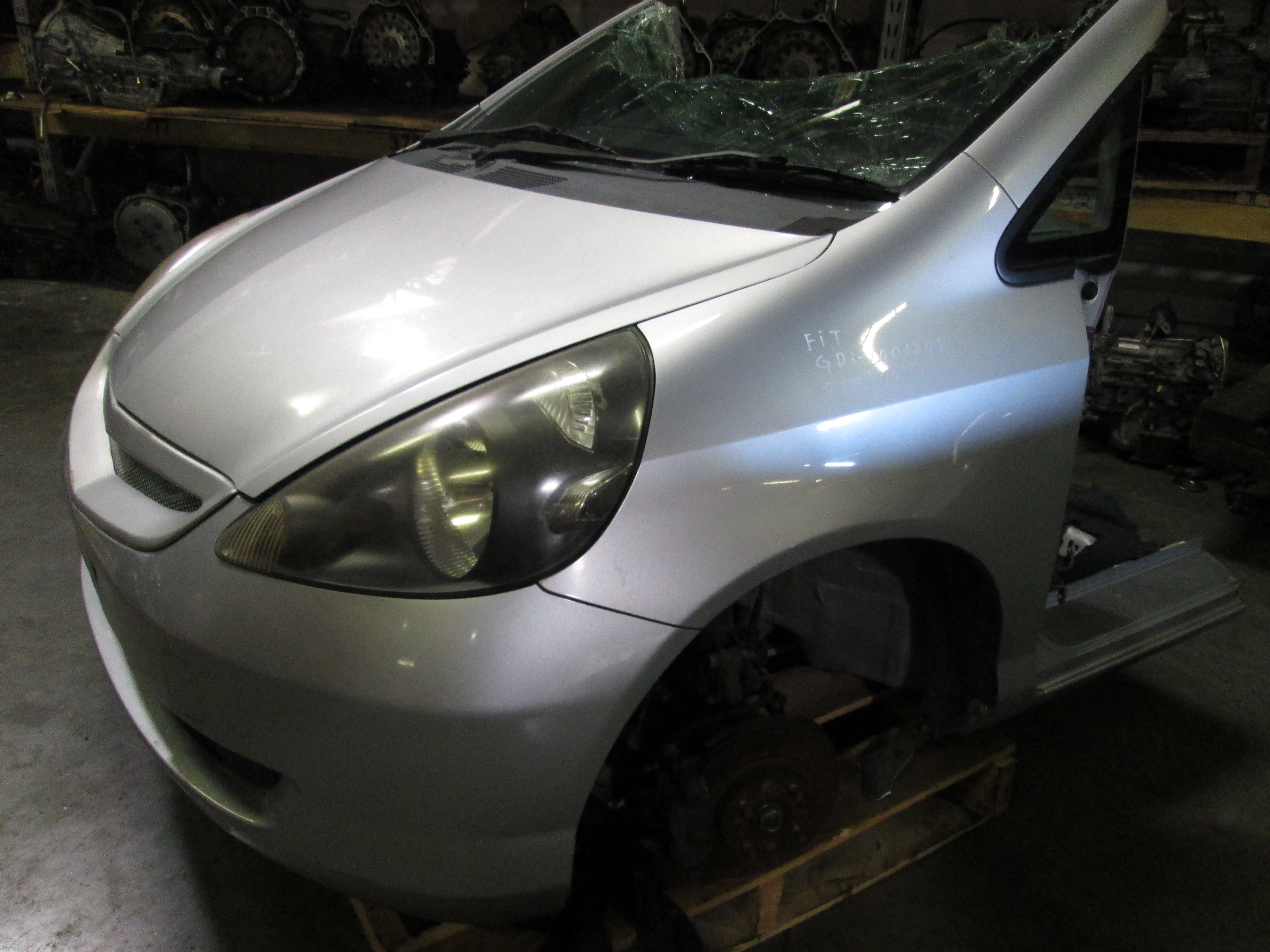

Older Fit JDM thought it was interesting, but found this:
Honda Fit GDi L13A 2001 Front End Nose Cut Hood Bumper Fenders Lights
Honda Fit GDi L13A 2001 Front End Nose Cut Hood Bumper Fenders Lights - $799
