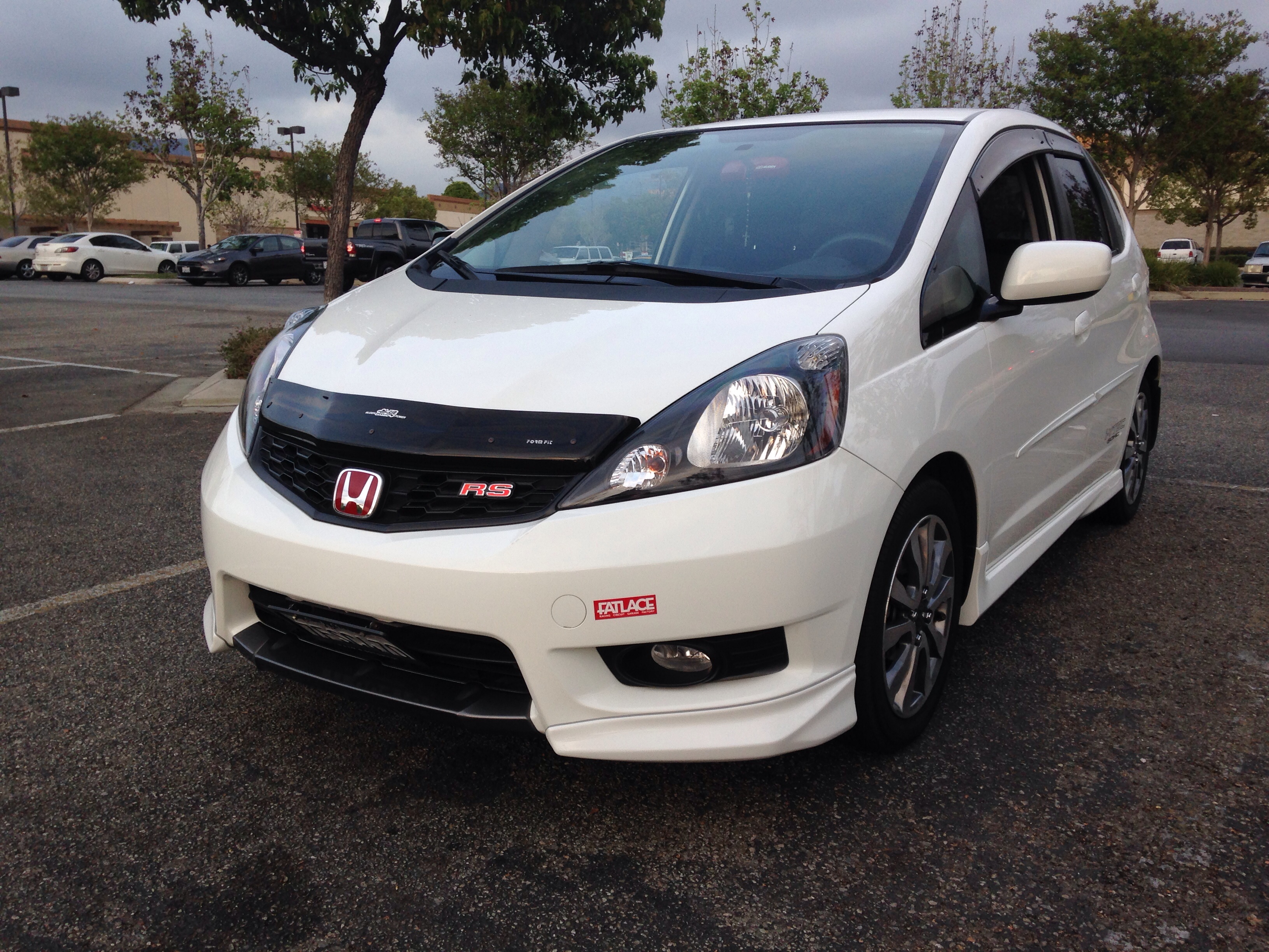

I have the same hood deflector and didn't have any issues here. One thing I did have trouble with is you have to push the metal clips all the way flush onto the hood there can't be any gap so you will have to push with some force so they sit flush.
This photo isn't a fit, but you can see that the clip has to be pushed all the way to the edge of the hood with no gap.
good luck!

Here is the deflector on my hood.

thanks for the reply; added paragraphs/breaks in the original post to make it easier to read. i had the clips tapped all the way into the hood edge, with no space between the end and the clip.
underneath, however, the way the clips are angled has them lined up perfectly with the holes, but with a gap of half an inch to three quarters, i'd estimate.
i sent photos of the brackets (off the car) to the seller, asking if maybe the wrong ones were included somehow. the deflector looks great on your car, but appears to be a different model, maybe. the only word on mine is "fit" in the right corner, i think.
at this point, i need new protective tape and brackets anyway, as the brackets got a little bent, though still not close enough.
