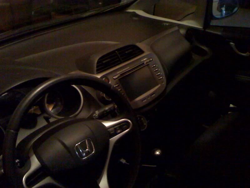

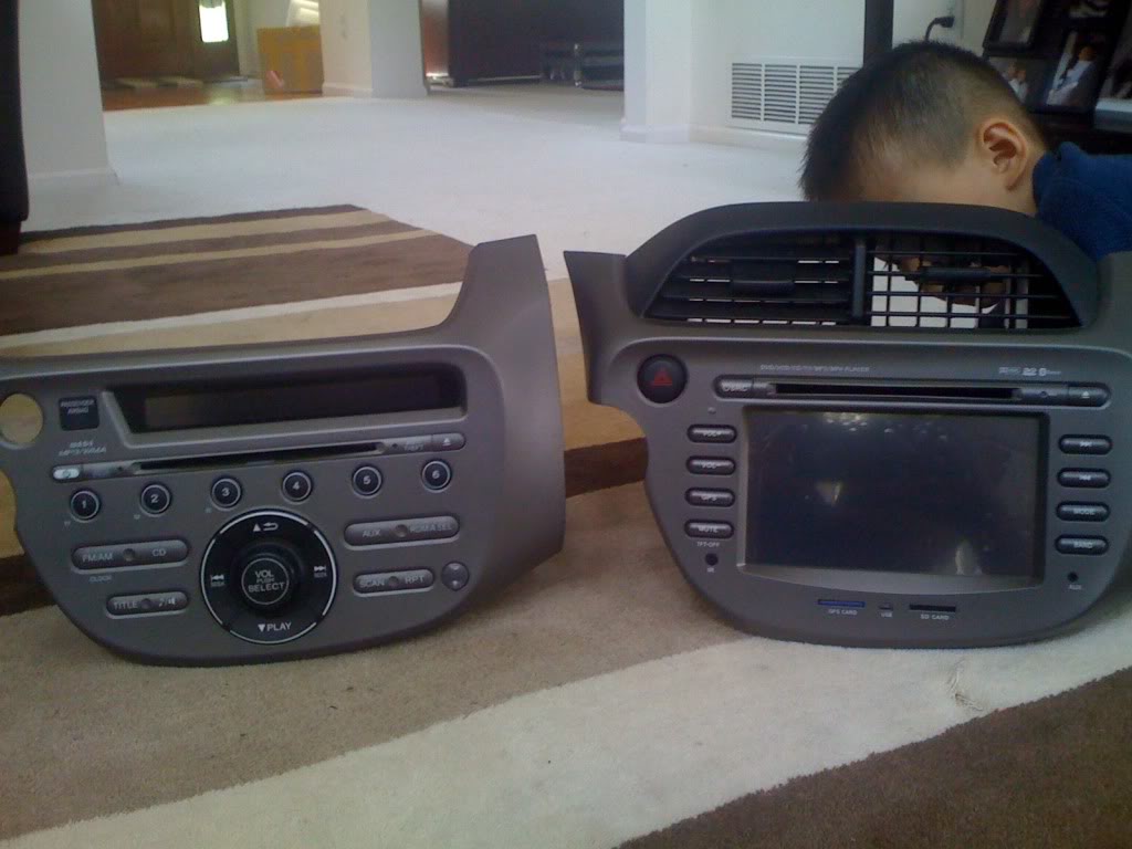

Out with the old & in with the new!
Installation was a breeze

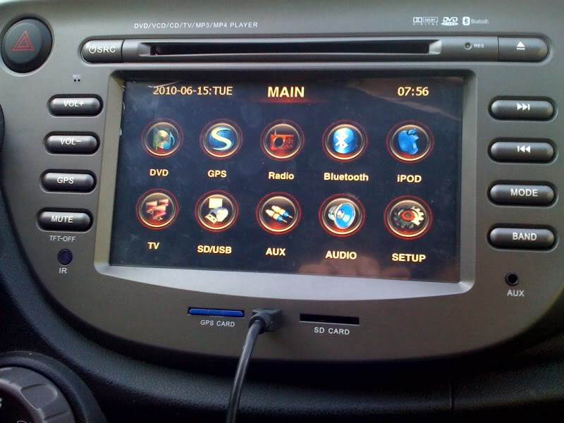

Main Menu

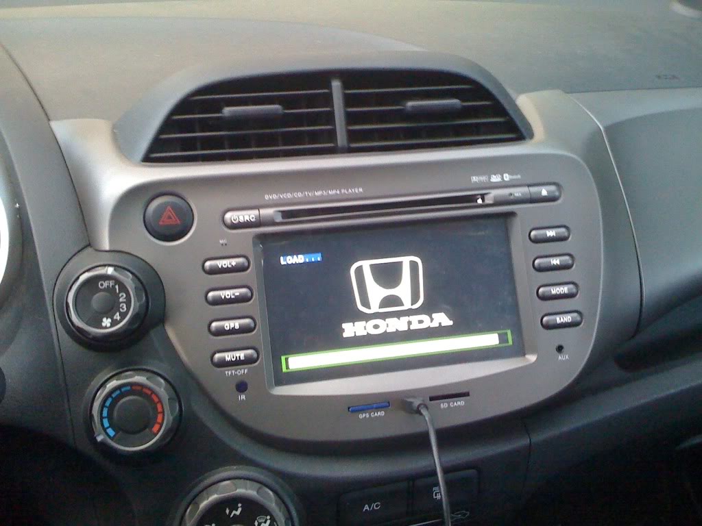

Loading screen for DVD

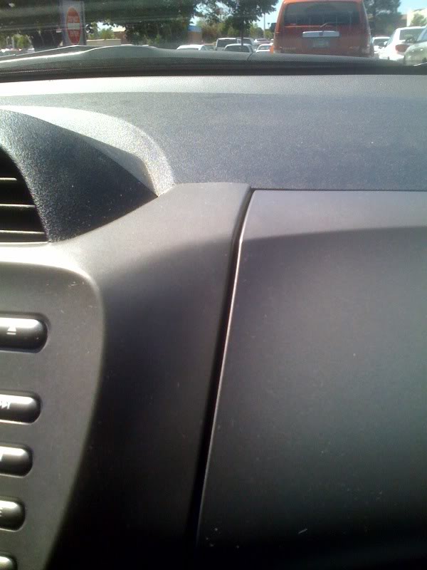

Notice the finish is a little darker in direct sunlight.

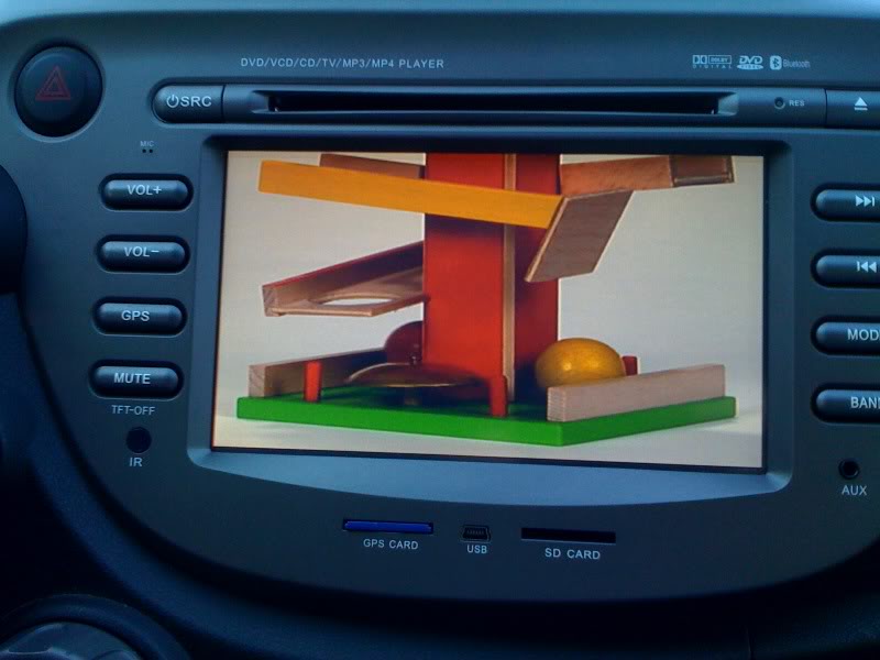

Video quality is very high. Testing my son's Baby Einstein's DVD.

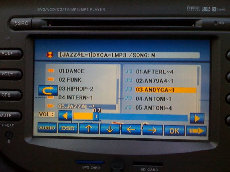

USB mode: Fugly interface! but I'll live..

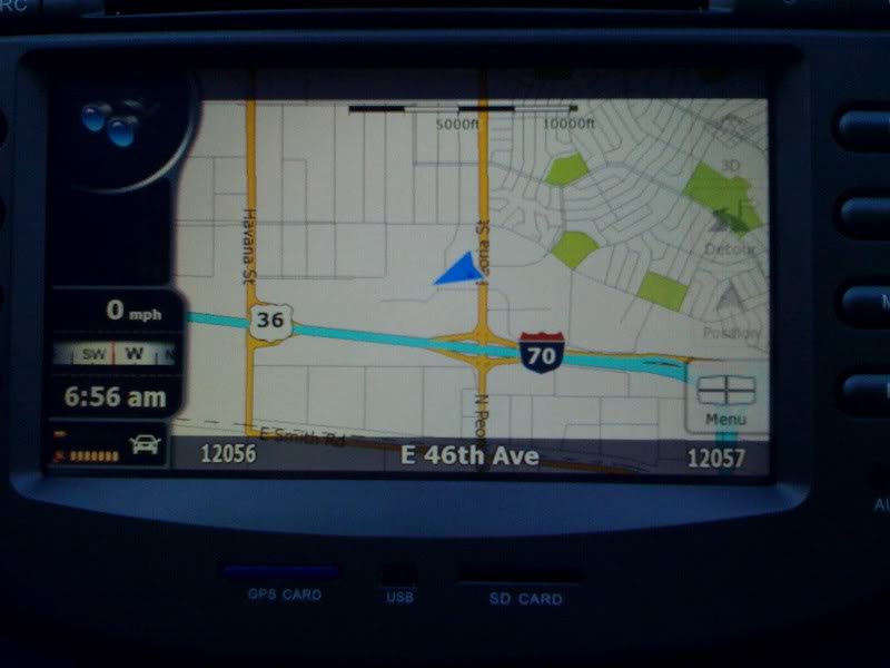

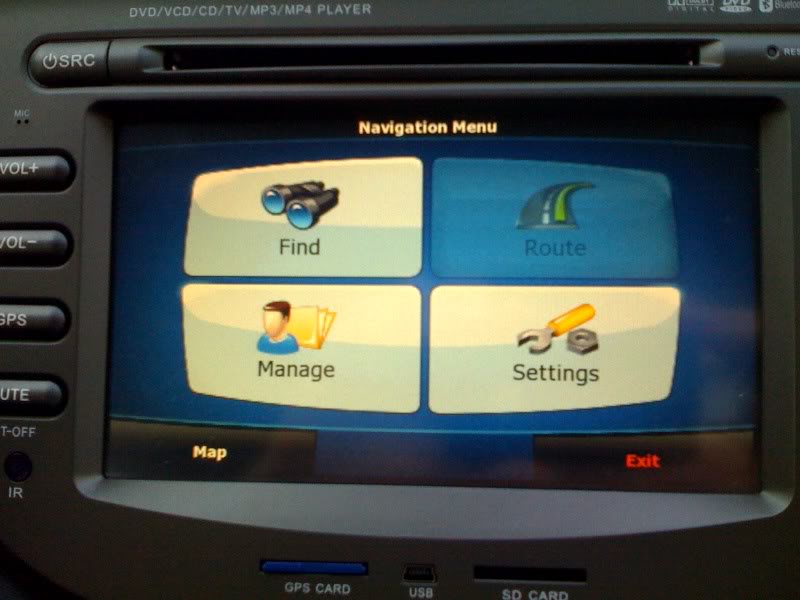

Navigation Menu:
Map at daytime. (At night the map changes to a black & blue theme)

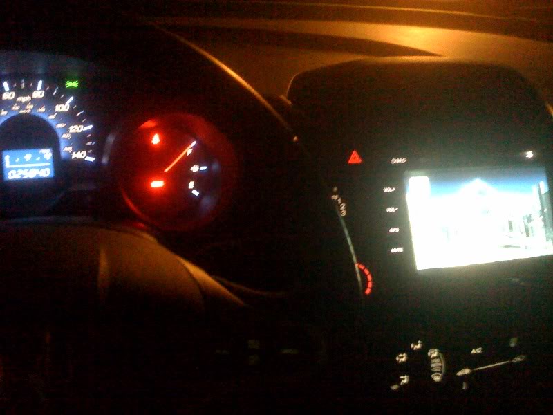

Unit at night. The buttons light up bright white unlike our dull buttons.

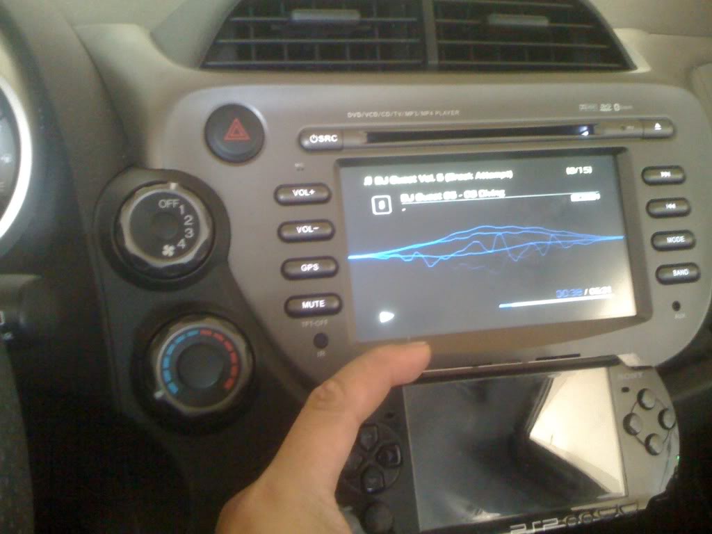

Update: Here's a couple pictures with the PSP hooked up via A/V Composite cables, wish this unit took Component instead so I could play games.
