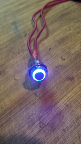

I plan to install a hard wired garage door opener in my 2015 LX. The push button will be a blue LED momentary switch installed in one of the blank positions at the lower left of the dash. The switch is on order; but hasn't arrived yet.

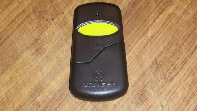

The remote will be somewhat modified and hidden under the dash. The remote is here. The following pictures will show what I have done, so far.
I ordered The Stinger remote from Amazon for $19.00. I chose this one because it is 12V; and is compatible with my Genie garage door opener. I used it for a week just to be sure it worked. It did.

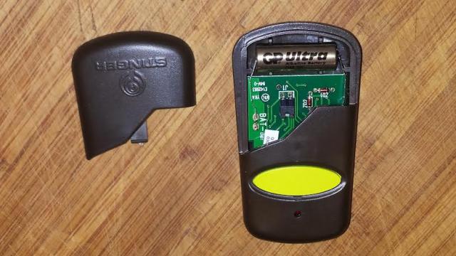

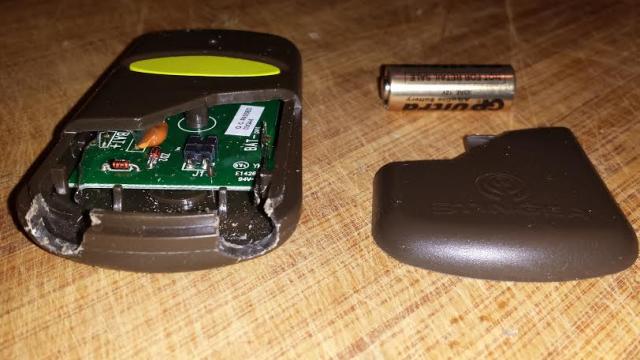

Removal of the cover shows that The Stinger is powered by a 12V A23 battery. The battery is held in place by flat spring steel terminals. The terminals are sized so that 3/16" inch female connectors will slide onto them. Good deal, no soldering required.

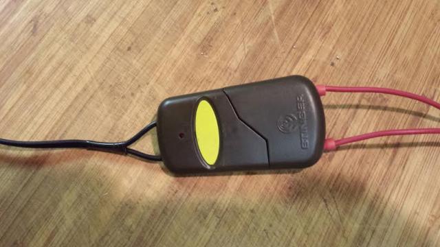

3/16" female connectors were crimped to 16 gauge wire and attached to battery terminals of the remote. I would have preferred to work with smaller wire; but 20 and 22 gauge were not readily available in my area. No big deal...just a matter of preference.

This is how it looks after it is all buttoned up with the battery cover replaced. Notice the tape holding the activation button down. The button is recessed so I used a piece of hard rubber door stop between the button and the tape to insure electrical contact for the button. The new momentary switch in the dash will become power control switch.

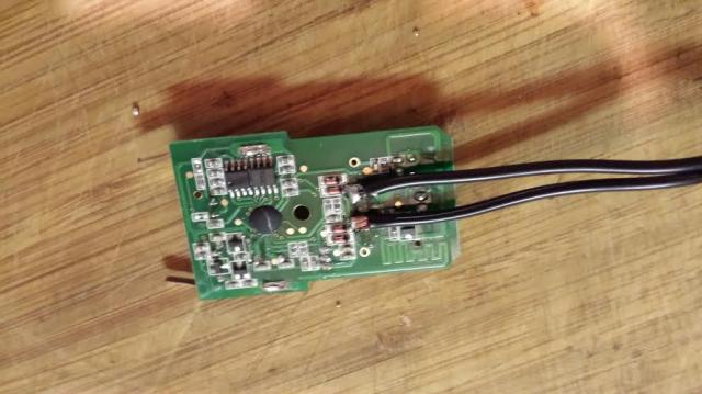

OK. Disregard the last picture. The plan was to use the new in-dash switch to control 12V power to the remote while the remote button switch was permanently taped down. That plan didn't work when I tested it. I really can't say why it didn't work; but I suspect it has something to do with the fact that my door opener and remote uses a rolling code that changes each time the door is activated (Genie calls it Intellicode). It operates fine using 12V power from the car instead of the 23A battery; but only if the signal goes through it's internal switch connections.
I solved the problem by removing the circuit board and soldering wires for the new in-dash switch to the existing poles for the original switch.

I Dremeled notches in the case for the two new wires, re-inserted the circuit board, and closed it all up again. This is how it looks now. The black wires will activate the remote through the new momentary switch in the dash; while the red wires will provide 12V power only when the ignition switch is on. The new switch still hasn't arrived. I will update the post when everything is completed.

The dash switch arrived yesterday; but college football on TV took priority over the garage door opener project. Today, I did a temporary hookup of the switch to the modified remote to test the function. I also ran 12V power to the switch to be sure the LED worked. All went well with both tests. It rained all day here today; so I didn't work on the actual installation for the car.
The camera doesn't do well at portraying the actual color of the LED. In real life, it is a good color match with the blue of the dash lights.

The button looked great with the blue lighted circle around it. Unfortunately, you will have to take my word for that. After the installation was complete, I turned on the ignition for the moment of truth. The switch glowed a beautiful shade of blue for about three seconds before the LED burned out. I guess they just don't make things to last in China.

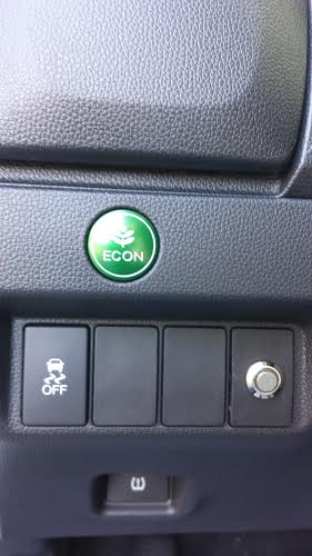

Oh well, on a positive note the switch functions great. It goes dead when the ignition is off and triggers the door when the ignition is on. I'm undecided if I want to try another lighted switch or just leave well enough alone.
Not too impressive without the light; but here it is installed.
More than likely, it didn't have a current limiting resistor built in. An American or Japanese or German made switch with the same sort of design would likely have suffered the same fate.
(Why, you may wonder, would they omit the resistor if it's necessary for proper operation? One good reason is that the resistor value varies depending on the supply voltage, and the maker doesn't know if you'll be using the switch on a 5V or a 12V or a 31.4V circuit.)
