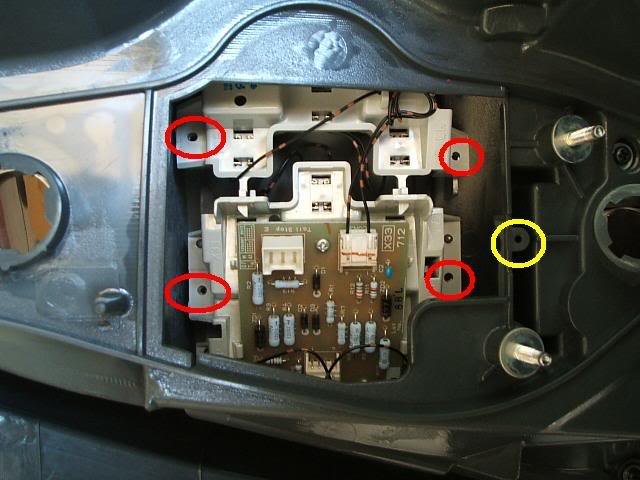

2. What sizes bolts do I need in below picture? and where to buy?

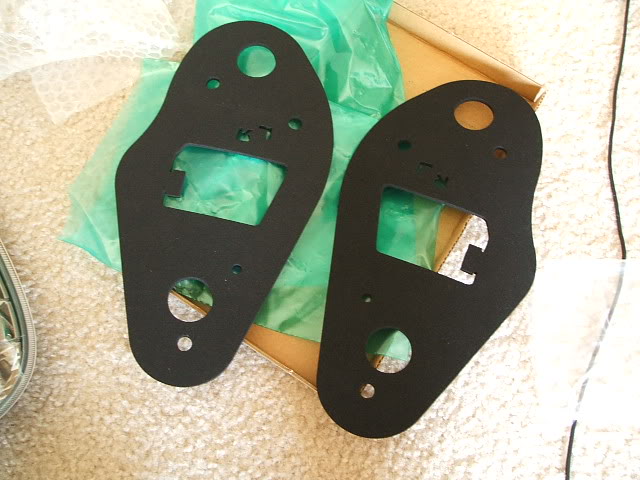

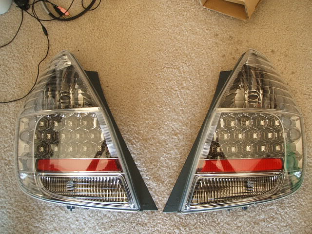

3.Are these two extras? I have total of 4 (They came in LED board boxes)
When i had the same taillights, they didn't come with screws either. I just took the tailight to my local OSH and went to the screws section. I found some self-tapping screws that fit snug into the holes. The thread is not pre-threaded so u could use either SAE or metric. Use some screws maybe 1/2" long, that's plenty long enough 2 hold those things in.
Yeah they are extra, u only need 2 of them to install the taillights.
hope this helps ya!

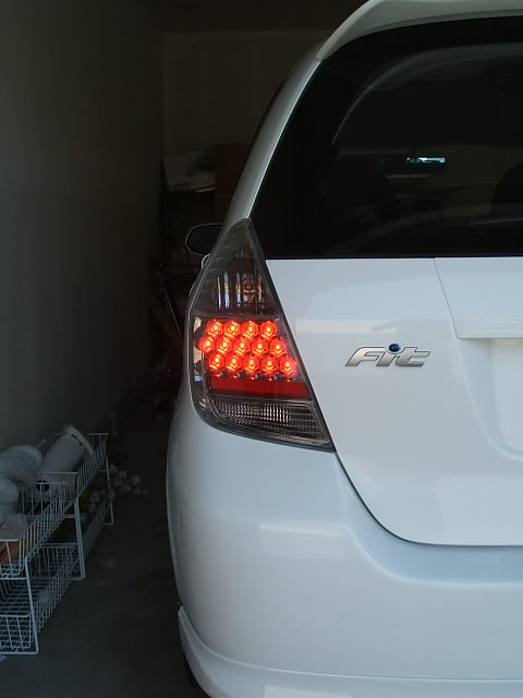

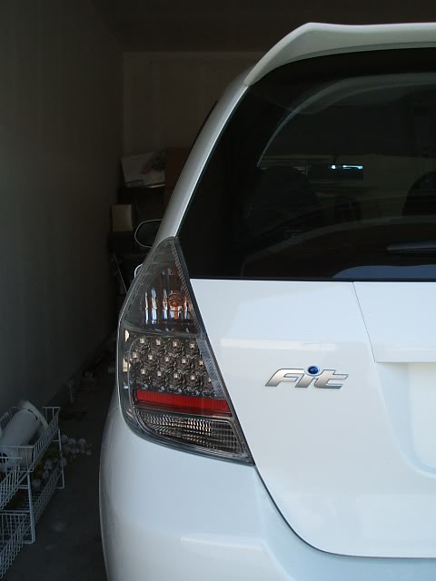

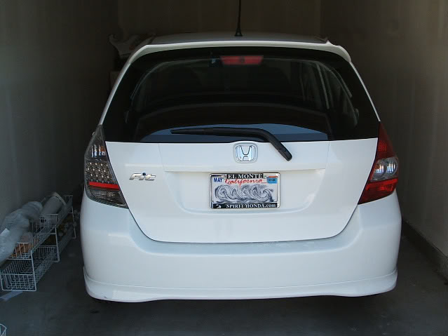

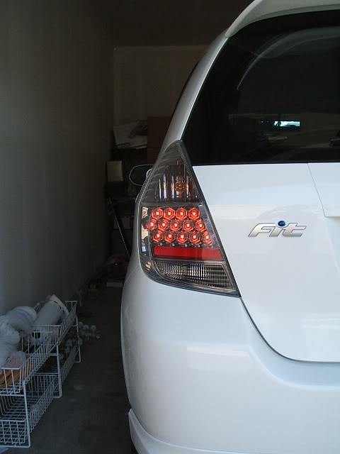

TEST FIT today, see how it looks on the car(looks freaking awesome), i want to put both of them on badly, but i dont know how to do the wire extension, seem like the driver's side reverse light needed to be extended, passenger's side i havnt looked yet. So, ya, have to put the stock light back on tonight and wait till next week so that Koolkev has time to help me with wire extension.
Anyone near Inland Empire know how to do this?
enjoy some pics
off
parking light on
step on brake

It really is not hard at all to extend the wires. All you are doing is cutting a wire or 2 and adding a new piece in between the cuts! Also you dont HAVE to go the solder route, you could just get crimp connectors, thats what I did.
Plus get yourself a chrome/amber bulb for that turn signal, will look SOOO much better!
To give you an idea, doesnt this look so much cleaner?
