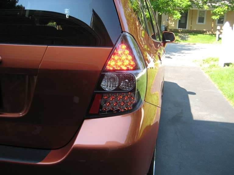

You just gotta dremel out part of the opening to get the bulbs to fit snug. Take your time and you will see exactly which of the 3 openings need to be extended. Mine are nice n secure. Also a good time to swap positions for the turn and reverse bulbs.
Chrome/amber on the outside for turns. Clear on the inside for revers.

looks nice all lit up!
