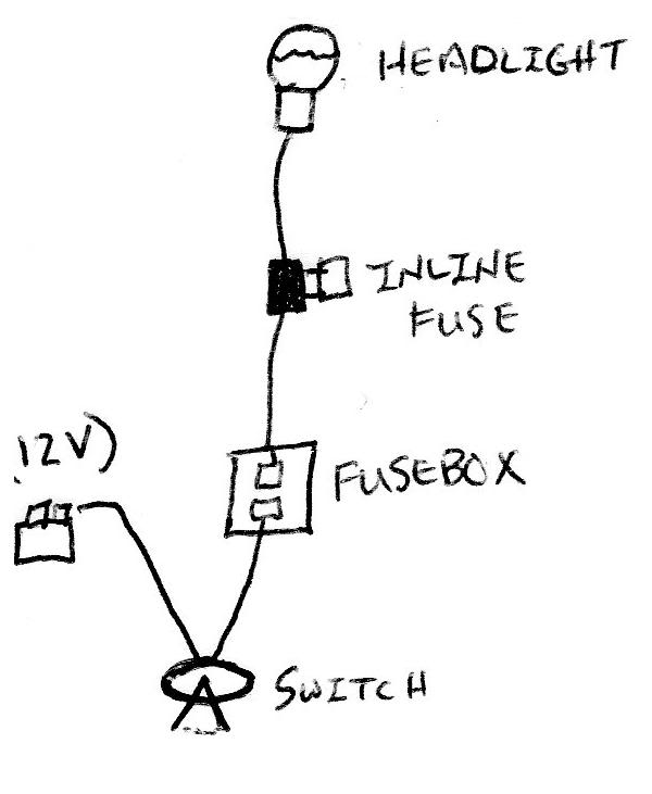

Excuse the childish drawing, but this is basically what you're talking about. Power wire from 12V source to switch, through FUSE #15 slot, to headlights with inline fuse? The inline fuse go where I have it, or between the fusebox-switch, or between the battery-switch? Thanks for your patience...and VERY good idea!!! + Rep for you Niko!!!

your close.
from your picture just take off the 12v source and the headlight.
put those two wires together to create a circle.

Here I fixed the drawing for you. You don't need the 12v and bulb because you already have 12v coming in 1 side of the fuse and the other side already lead to the bulbs.
This switch will essentially turn on/off the DRL circuit.
