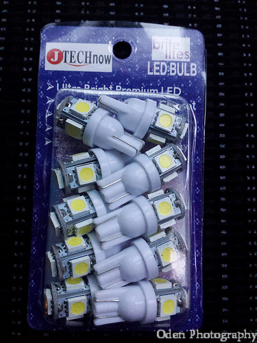

LED Bulbs from Amazon. For the price these were not bad. Color wasn't too "blue" for my taste and has a good brightness level for interior lights. Not dim, and not blinding. Maybe 10% brighter than stock bulbs that comes with the Fit.

If anyone else is still watching this thread. Do not buy the Jtech LEDs from Amazon. Ours are already flickering on and off after a year of use
-Agreed. I'm the OP on this one and I've had the exact same issue. Its been a little over a year and I've replaced half of them due to the flickering. Currently replacing with the extra's I had from the original install but want to find a good replacement.
Anybody have recommendations? I'll update the original post with your guys recommended brands. Links would be great.
Amazon.com: Jtech 10x 194 168 2825 T10 5-SMD White LED Car Lights Bulb: Automotive Amazon.com: Jtech 10x 194 168 2825 T10 5-SMD White LED Car Lights Bulb: Automotive

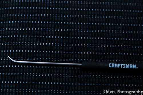

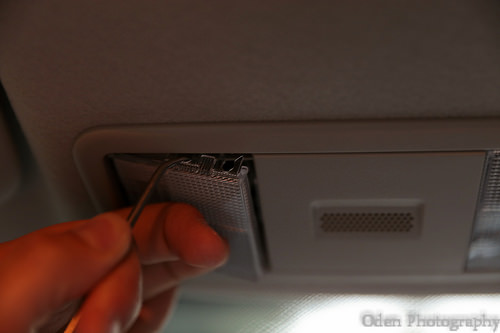

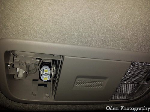

Pry tool. This is what I used which was just okay as it marred the plastic housing a little bit. I Tried a flathead screwdriver first which was much worse. The plastic housing is VERY SOFT so be gentle. I think a good suction cup would work best for the map and dome light so if you have one, try that first.

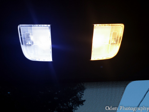

Left bulb LED, Right bulb stock:

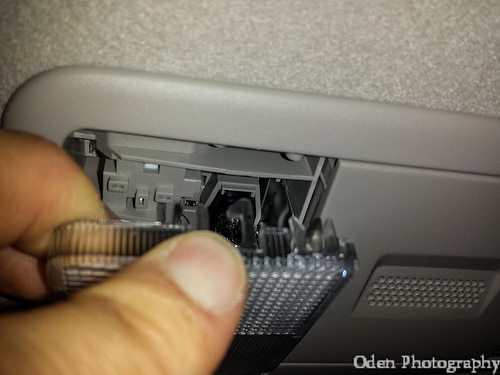

I used my hook tool to reach in and pull out from far right corner, then the center. The clear lens clips onto a round thing inside. Doesn't take too much pressure to pop the lenses off.

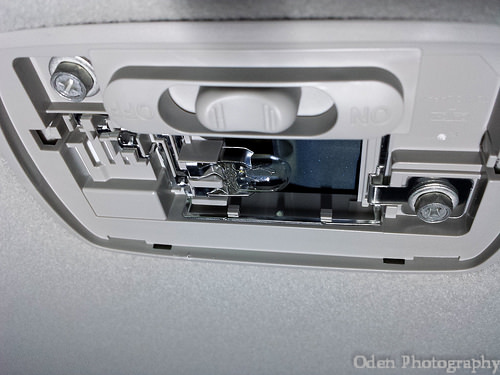

The LED bulbs are slightly longer than the stock bulbs but fit just fine

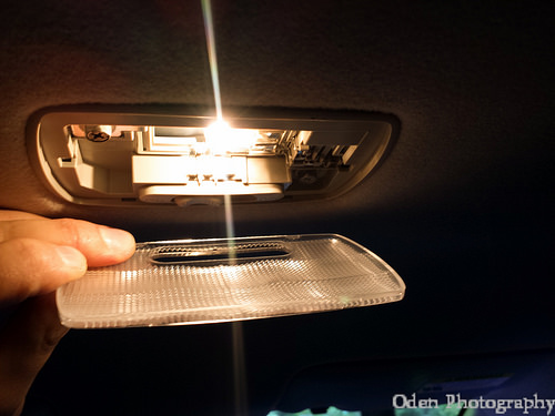

Dome Light: The casing is held to the housing with 4 little numbs. I just had to pry at one corner and it popped right off.

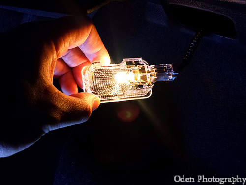

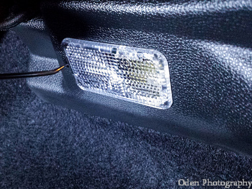

Cargo Light: This is one area that needs a brighter bulb. If I find a good deal for a brighter LED I'll pick one up.
***Update 8/2/14*** Go here for my followup post on a much brighter LED: https://www.fitfreak.net/forums/3rd-...provement.html
You'll want to pry from this corner. It hinges out.

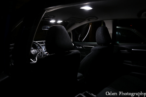

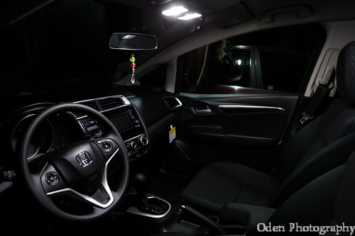

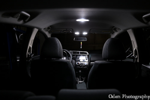

Completed Project:

Great write up! If you find a brighter LED that would be well suited for the cargo area, please let us know. I can't wait to order some of these and try this.

Just upgraded all of my interiors and license plate bulbs with the same LEDs on my 1st Gen. Has to be easiest and best value upgrade you can do to really any car. At night the single LED map light bulb lights up my entire interior.
Nice writeup!
