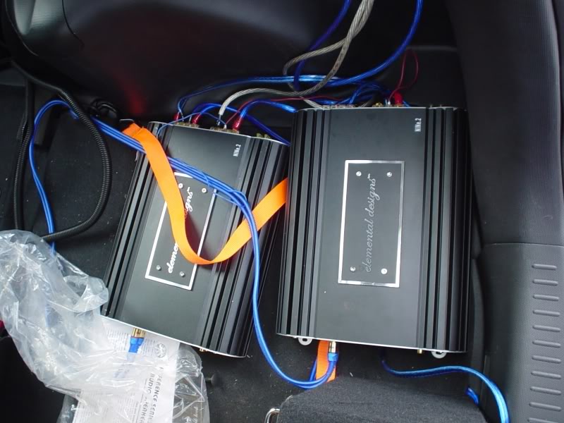

After months of stocking up on equipment I finally put most of it in. I am still trying a way to mount both amps in a way to keep most of my cargo space.

I really hope your not leaving your amps like that. Also, shorten the slack between your battery and fuseholder, and put some wire look on the power wire under your hood please.. safety first!!! Otherwise, enjoy the system
Also seal up that hole. That will ro you of more midbass than anything.

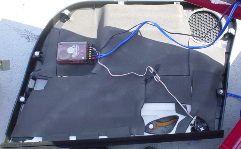

Cool. How are the crossovers attached to the door panel? Double sided tape? I am hoping to one day upgrade the stockers to either components or 6.5 2-ways. I know components are better, but in my old Civic with stock HU, I had some Polk dB somethings and they sounded really good - better than my old Pioneer components in my 2000 Civic.
On a related note, if you were to power door speakers with an amp, should you use upgraded wire? I could never figure out how to run the power wires through the doors in the Civic, so I just tapped into the speaker wires at the harness. I have much to learn, but I know a good set of components will sound great powered by a sub.

Depends on how owerful the amp is. It's always better to upgrade, but I don't see any problems using the stock wiring for 45Wrms or less.

I am gonna mount the amps to some carpeted MDF, I'm trying to figure out how to stack them. I'll tighten up the batt cable. I have some loom, I just wanted to make sure everything fits before i started finishing up.
The x-overs were mounted with gray double sided tape (the white one is garbage).

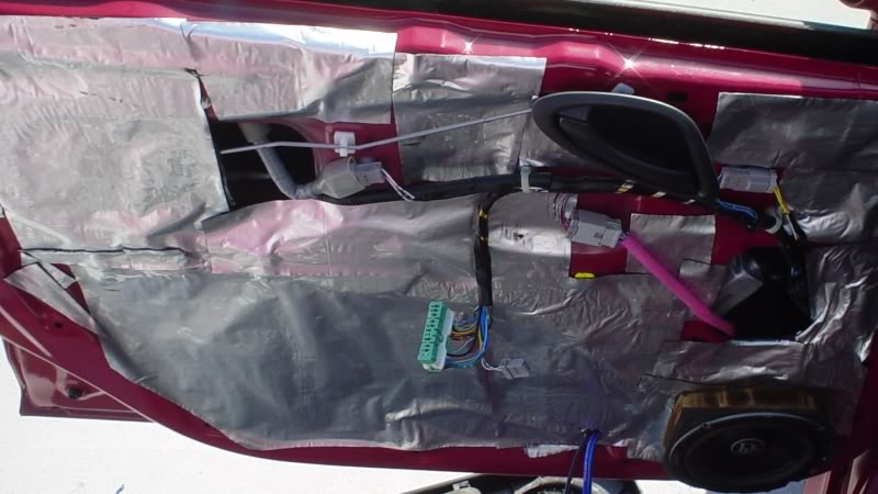

getting the speaker through the door grommet was not too bad on the passenger side; The drivers side was a bitch.

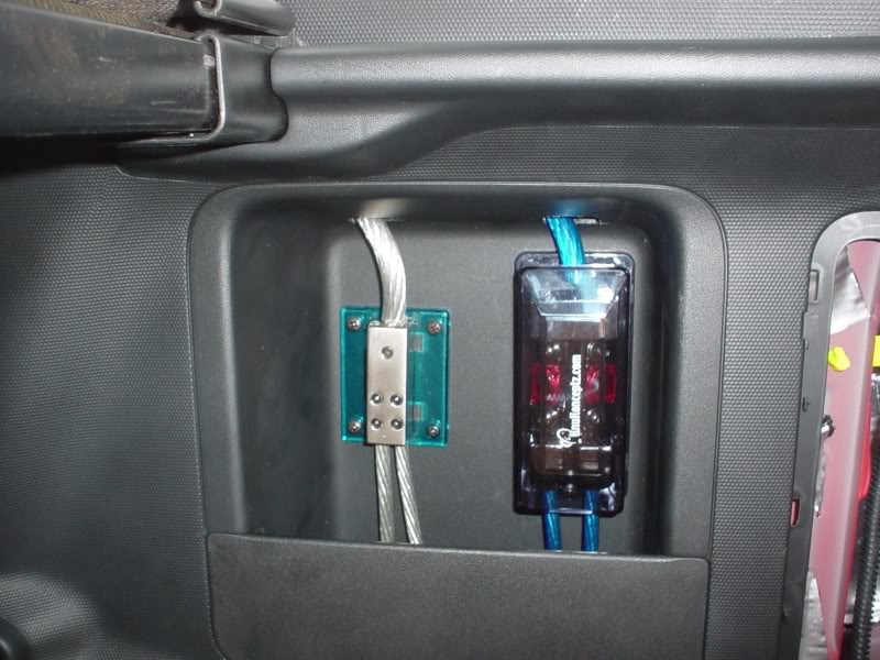

Is the distribution on the left for the ground? Two amp ground from the botton and output in the top?

Yes the left one is for the ground. The 2 8AWGs goto the amps and the single 4awg is grounded to the chassis.
