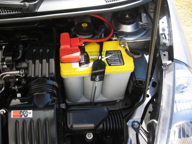

Okay so currently my 2007 fit base model is at the honda dealer getting a new starter installed because i fried my original one. I think this was caused by my battery trouble. So a little info about my fit: I have installed a 4ch 400W Clarion amp I have replaced all 4 speakers and have installed a Mtx 12" sub in my trunk. I am currently running the speakers off 2 channels and and my sub off the other 2 channels. I also have a double din Clarion DVD h/u installed. So after installing all of this, i've had battery issues from the start. But my battery is gone completely my car won't start with out a boost. I've gone to several car part distributers and they have all said there is no aftermarket batteries that the alternator will be able to handle and there are no aftermarket alternators on the market. There must be somthing I can do instead of buying a OEM battery and wrecking another one. can somone please give me some guidence on what to do next, thanks.

Buy an Optima D51R yellow top. It fits.
