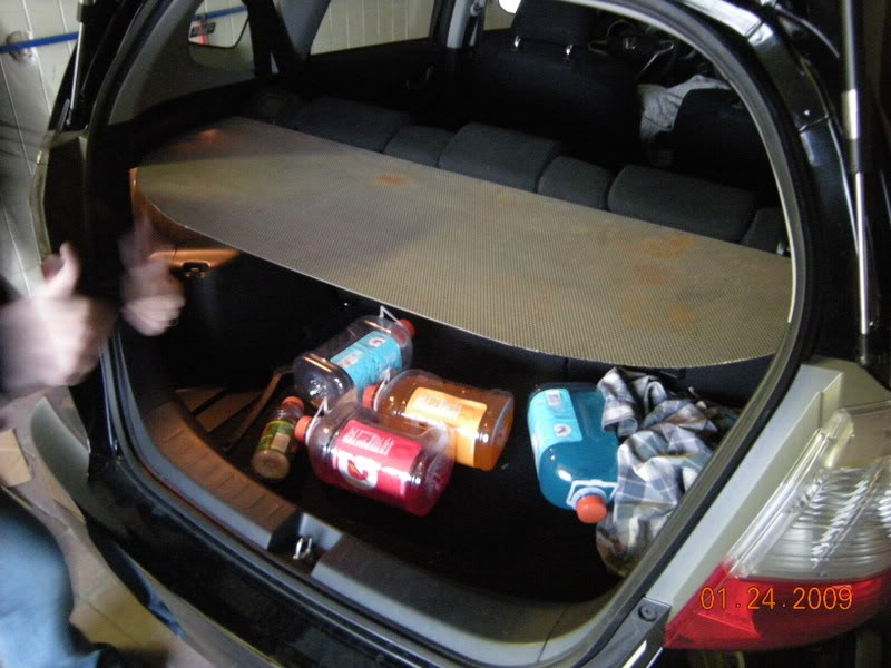

I decided I didn't want to front out the money for a factory cargo cover so I went to the drawing board. I got a cardboard box and cut out a pattern. Drew the pattern onto the sheet of steel I picked out. I added an extra 1/2" of material to the side facing the seats. I cut it out with a cutoff wheel, put it in a break and bent the extra 1/2" down to stiffen it up a little bit. I haven't painted it yet but here it is.

not bad. im feeling the same way dnt want to buy the oem cover
Old Jan 28, 2009 | 03:26 AM
HONDAMATIC's Avatar
Posts: 1,850
From: hawaii
should roll some beads in it too and put spray on bedliner

looks like the car could use it as a weapon in the event of an accident. good thing you bent the edges down... decapitated much?

I'm actually going to run some rubber around the outside of it to keep the edges smooth. I'll get some finished pics soon.

what are you using to secure it? I'd be concerned of it becoming disloged in an accident and lopping my head off.

attach magnets to the ledge it mounts on

pretty cool. you can actually stack stuff on that one. unlike the oem cargo cover. i have the oem one, so thats a compliment haha

Good luck keeping your head on if you get into a serious rear ender. That sheet of steel will chop your head off like a hot knife on butter.

If I were you I would maybe consider attaching one or two straps to the cargo cover on the bottom (don't ask me how) and then connecting them down to the tie downs to anchor it. gotta keep that head on.

When I built this I made it with safety in mind. In order to put this in, you have to fold down the back seats and slide this in place. The seat keeps it from coming forward and there are 2 pieces of plastic on both sides that keeps it from coming up.
