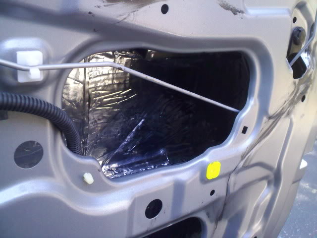

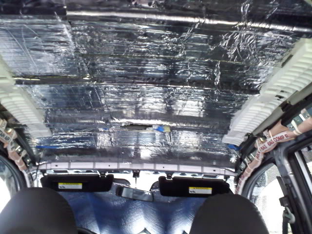

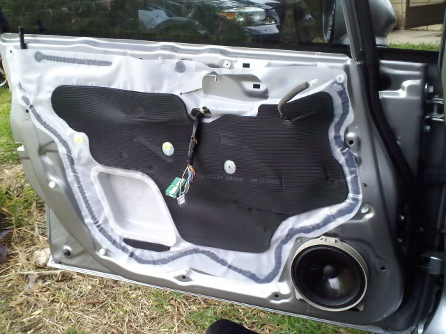

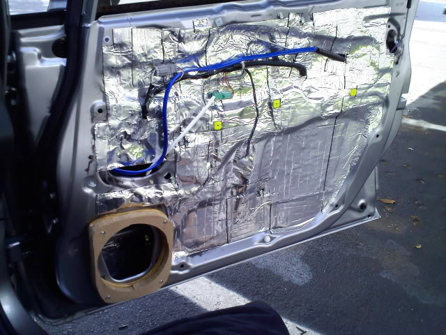

So here are the pictures that I took while deadening my Fit
Stock doors look like this:

With the moisture barrier removed and deadening on the outer skin:
Closer picture:
Covered up the larger holes with aluminum flashing:
Finished door with speaker ring:
Deadening on the roof:
Those are all the pictures I have. I felt that it did make a large improvement along with the new components that went in at the same time.
