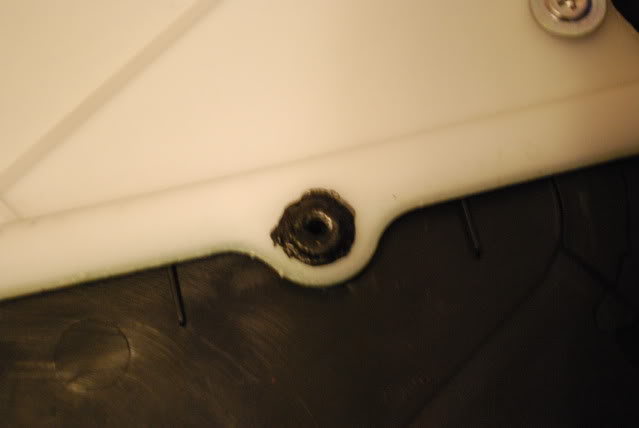

so the only problem i have is taking the door insert off it is held in by like these melted plastic rivets. if i take these off how am i going to get it to stay on when im done wrapping it?

ok this is what i figured out to do. so i took a razor and cut off the melted plastic rivets. when i put the panels back on im going to apply a very thick glue to those spots.

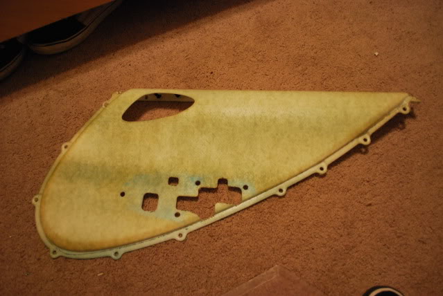

so i took my panel out and took off the old fabric cause i didnt want to go over it and this is how it looks

Excellent. I was also wondering about those plastic inserts. For putting them back on, I would use a hot glue gun. An industrial type hot glue gun will make anything stay, especially if you're going to be putting plastic to plastic. And those melted rivets are basically from a glue gun.

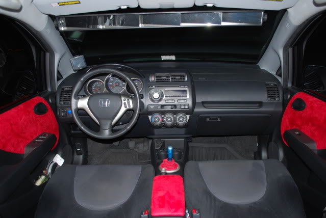

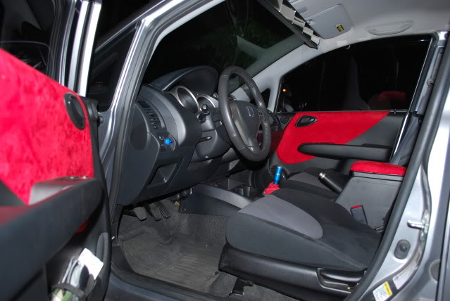

ok so i finished!!!
this was a really easy project not much too it. i used the hot glue on the lil rivet spots and it worked great! here are some pictures.

What's that you have for your rear view mirror? Looks like five stuck together... never seen anything like that before.

to take off the fabric it just peels off nothing hard really. they to add new fabric i bought 3M super77 spray adhesive

uh-oh.. you might have problems with the super 77 in the long run. i use that spray adhesive to mount posters onto foam-core and presentation boards; eventually the paper starts to peel and these posters just sit under a spotlight
interior looks great, btw! it's refreshing to see a solid color instead of all the patterns that everyone's been doing lately.
that's an old school super wide angle rear view mirror. Those were awesome to use.

I did it on my 09. I think you should remove the old fabric, there might be room problems if you dont. It tears off. It is a tough job, but that is the easy part. The panel is heat staked, or "melted plastic" welded on in 13 places. I ground them all off with a dremel tool and an abrasive disc, pull the panel, then drill out CAREFULLY each post, as they are origionally hollow. Do not drill through! EASY touch son, then I epoxy 4-40 screw studs in there. (Cut off 1" screw heads, put that side down.) Then you can srew the panel back on with nuts and washers. I thought it was better than slobbering glue, this is removable. My tip for bonding new fabric? Your fabric better have some stretch sir, some of those turns are rough. And only bond the top section with spray adhesive first, trying to do it all at once is not much time. Lots of nasty stretching to do. It is a lot of work my friend, but I think it is worth it because we hate that fabric so damn much.
