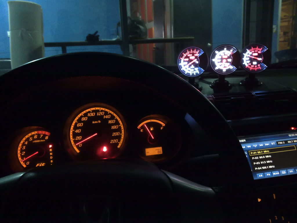

i think you should have bought other brands that has independent sensors...
here's my share.... vacuum/water temp/volt meter
IMG_0068.jpg?t=1285089810
25 in HG is my idle vacuum without AC on
19-20 with AC on.
HTH

i dont know the brand/model of these gauges...
my brother bought this from hong kong and gave it to me
thanks for appreciating
