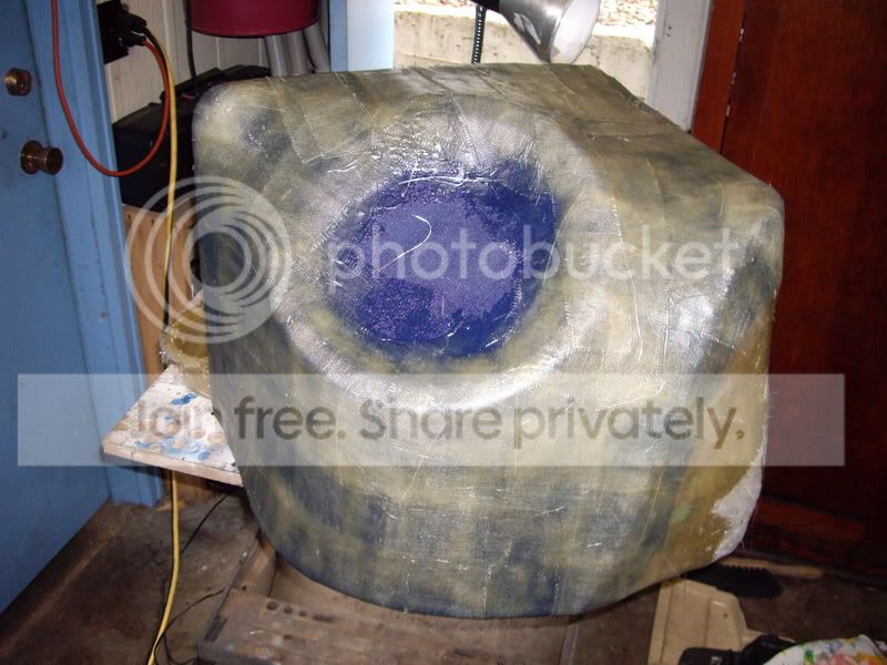

Here are some more pictures from my box so far
This is my amazing architectual skills in action!I didnt have any dowels so i just used scrap pieces of wood.It was hella sturdy for sure!
Here is before i put resin all over the face of the box,just around the edges.
This is after the resin has dried on the face of the box.Well im off right now to go do some more glassing so ill post even more pics when i get them.
Old Mar 15, 2007 | 09:42 PM
  #43
TotallyFit's Avatar
Posts: 112
From: Surrey,Canada
my bad in the last pic the resin is still wet.But it's dry now.

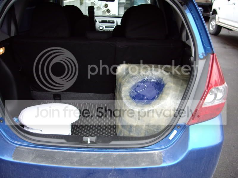

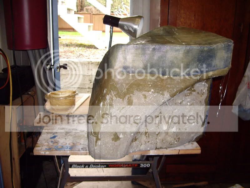

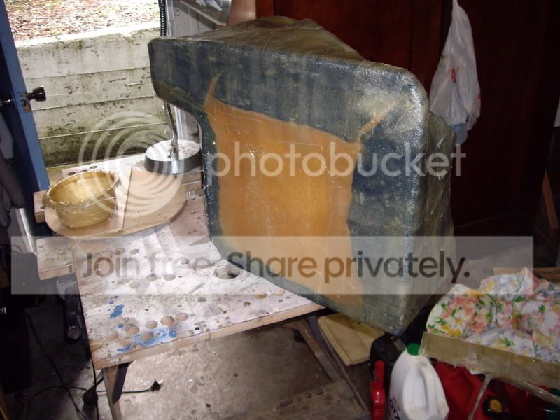

Yeah im hoping i wont need more than a thin layer of bondo by the time im done sanding the fiberglass.Here are some more pics:
Here it is after one layer of chop mat and 2 layers of weave mat.I prefer weave mat now,it's much easier to work with,and you get a lot less air bubbles.Im going to put one more layer on the face, maybe 2 in some area's, on wednesday, because im not happy yet with the amount of flex in some places.
This is the back where the amps, capacitor, and crossover will be mounted.I put some glass layers there because fiberglass doesn't bond super amazing to mdf so to be safe i made it like one piece of fiberglass on the outside.Ill be doing the same inside as well.
Here is the part that will be touching the inside of the trunk area.You might notice i decided to be unlazy and i got all that tape off finally.I used a sanding disc on a grinding and BLAM! It came off super easy.It also smoothed everything out really well so i wont be needing bondo there.
These are some shots of it in the trunk so far.As you can see it is pretty big,but ill still have TONS of space.You may also notice that i have it somewhat facing the hatch.That's so i get the best sound quality.And it'll look awesome when someone opens the hatch and a big ol' type R is staring them right in the face.
