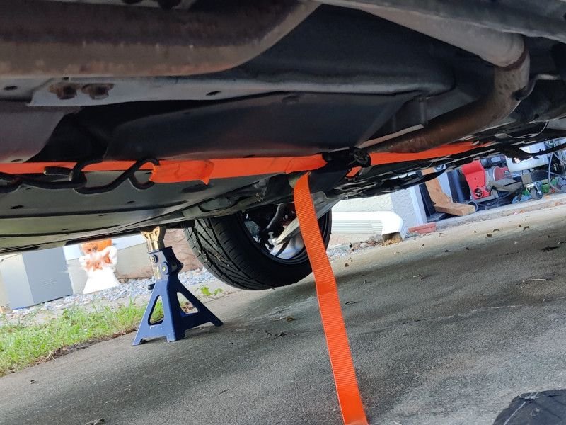

Used a front chassis bar as a pull point for my ratchet strap.
Just wrapped it around the torsion bar.
