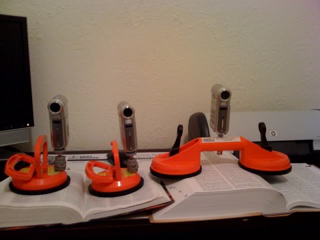

Old Dec 8, 2008 | 10:20 PM
  #32
AshPanda's Avatar
Posts: 445
From: Knoxville TN USA
Ok, now all i have to do is wait till it quits raining and snowing and start recording some footage! I cant wait, I have some cool ideas up my sleeve.
Old Dec 9, 2008 | 01:10 AM
  #33
ciburri's Avatar
Posts: 549
From: Dublin, CA., USA
Now that is what I am talking about!
AshPanda, I hope that on two mounts on the left you did not use original tiny screw that held tripod legs! I have couple of those small tripods myself. It is too small and weak. Drill the hole and tap it in a larger bore so you can use larger bolt to secure it to the suction cup. Don't forget to use a washer on the bottom inside suction cup! Also it appears that you mounted it partially hanging over the edge. It will hold, but it might vibrate and make footage unusable.
I am looking into cutting the handle of the dual suction cup and inserting an aluminum pipe with large pins on each side which would make the mount more articulate. As is you will be limited to mounting it on almost perfectly flat surfaces. I intend to use this dual mount on vertical surfaces of doors and bumpers and single cup on horizontal ones.
Can't wait for the footage! I hope you have something other than software that came with camera to edit it.
Ivan
Ivan
Thanks, I didn't use the little baby screw it didn't work. but i did use a bigger bolt and washer, and i could only find 2 small tripods out of all the mall's,bestbuy's,circut city's,walmarts, i looked every where and only found 2 so i bought them both. i'll definantly have to do some trial and error but i couldn't have done it without you. i probly would have spent a fortune, 3 cameras, three mounts three 2GB SD cards........Touge Videos here I come

Old Dec 9, 2008 | 04:01 PM
  #36
AshPanda's Avatar
Posts: 445
slide somethig metel under the plastic so when you drill through it doesn't go through the rubber , and then when you install the screw, bend back the rubber and stick the crew up into it and it comes out the top. once you get the suction cup you will see how it works. its easy
