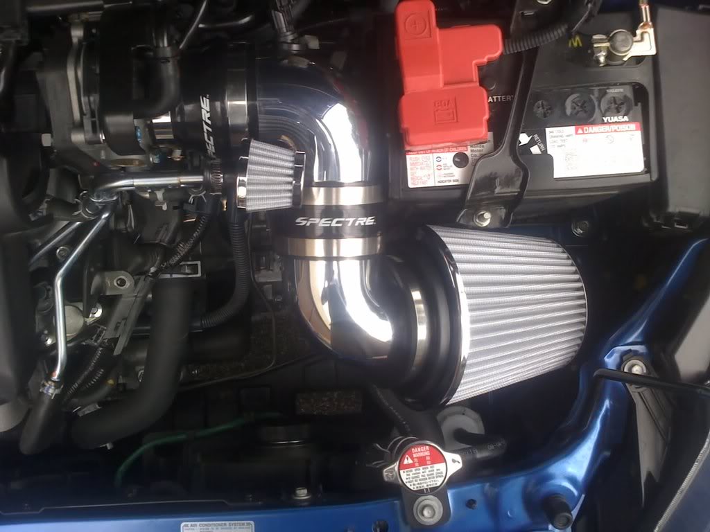

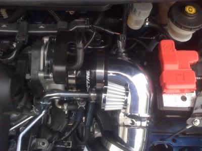

Got my DIY intake installed
the IAT wasnt that bad. but the wires could be alittle longer
it added a good sound and feel it on the butt dyno

It looks like you had plenty of room to drill the hole for the IAT closer to the rubber boot. If you want the IAT cable to have more slack, just buy another elbow for $10 and drill the hole closer.
Or plug the current hole and drill another.

Originally Posted by MemphisFit
no man, it was kind of a spur of the moment thing. everything was very easy to istall cept that dern battery. how did you move yours over? it also gave my engine a nice lil grumble
I didn't. I used the 3" rubber coupler with the 2.5" adapting washer. It's a good half inch shorter than the 2.5"-3" coupler that you used.

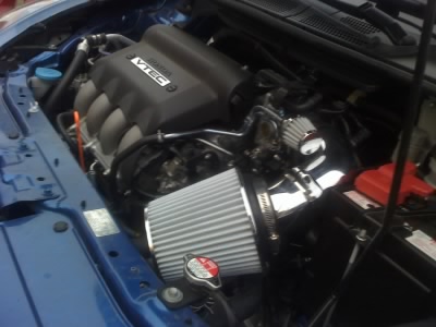

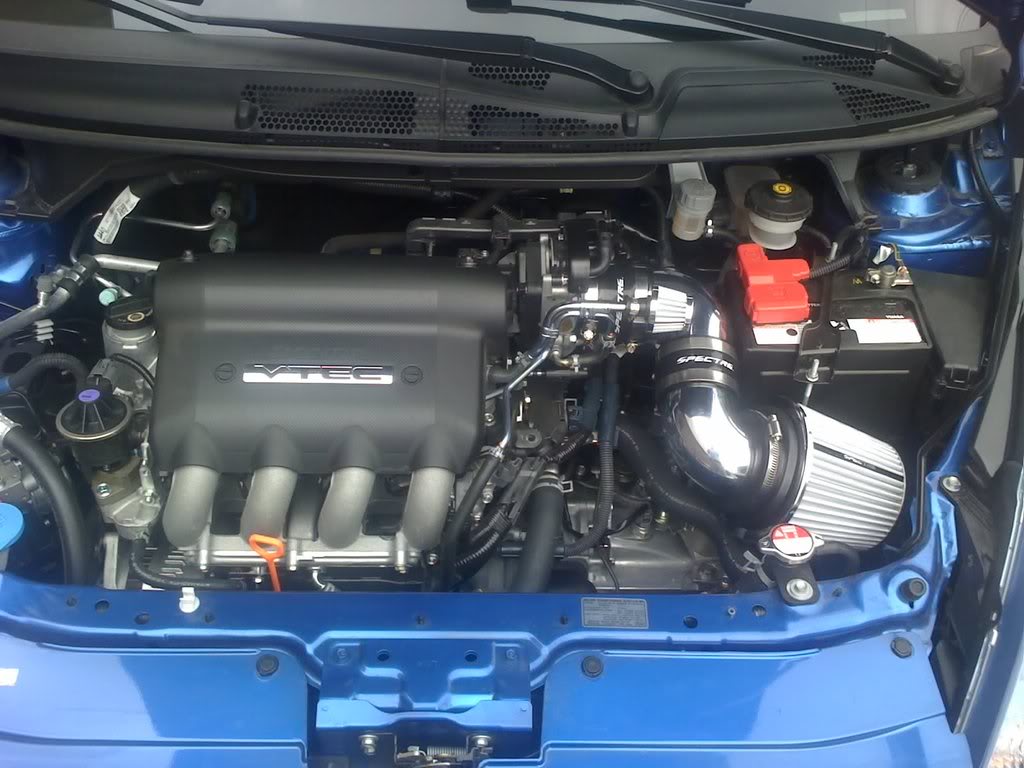

theres still a lil work im gonna do to it. i need to saw a little of the 45deg off. and maybe turn it the other way. thanks fo the help anyways sid and cojaro. when we gonna have ourselves a memphis fit cruise???

i turned it the other way with a 90deg bend

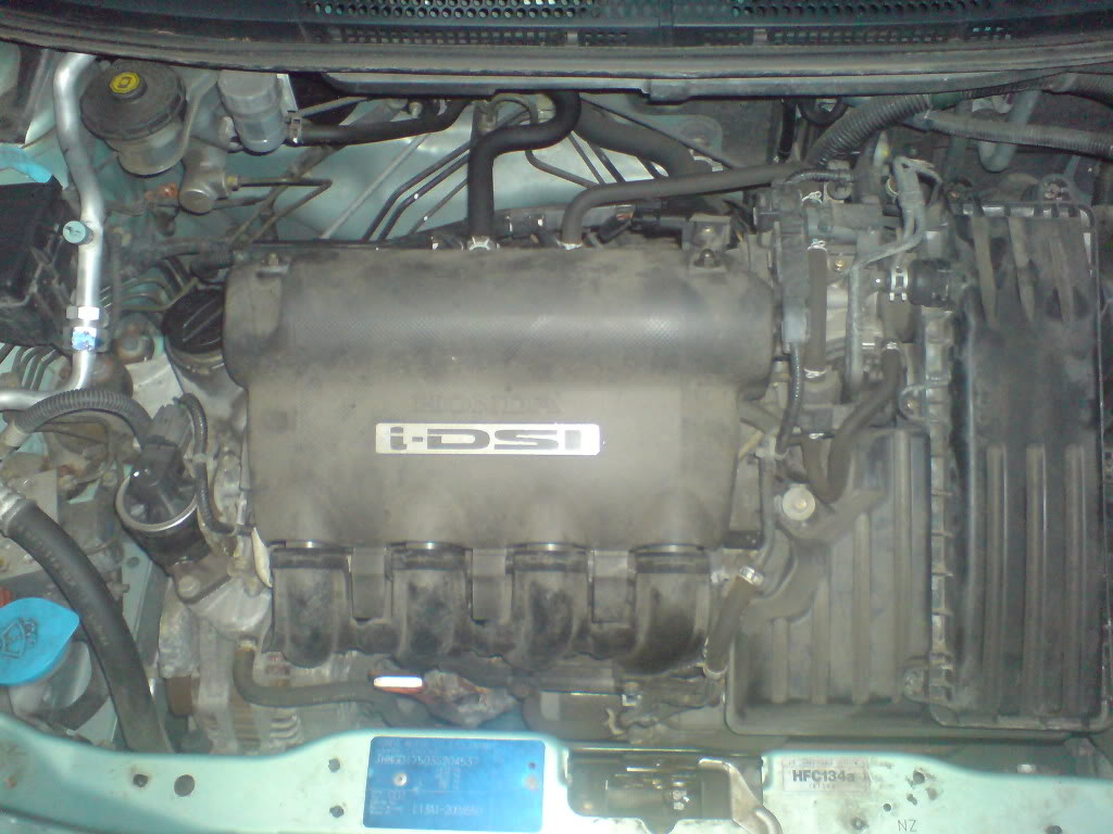

ughhh, i spent about 2 hours today trying to find the bloody thing and i still cant see it!
ughh!
can you circle where the iat would be in this pic
thanks
ps, dw about the dirt on it
Old Sep 23, 2008 | 07:00 PM
MemphisFit's Avatar
Posts: 239
From: Memphis
should be right around there. but this isnt an L15A? so im not sure. thould be a wire running into the airbox with a rubber gromet around it.
