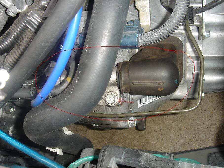

Ok, I'm a bit confused or we just don't have a delay valve. I was looking into my engine bay. I saw a clutch cylinder near the front. I was thinking that was the slave cylinder. Anyways, I took it out, disassembled it and found inside was just a spring. The rest was brake fluid and nothing else. If the one in front is the slave cylinder, then theres no delay valve in there. If that's not it, someone let me know.
The part I took out in red circle.

well i read up more on the s2ki thread and they're saying you remove the oriface and the spring & ball
but dude i don't know for sure because i don't want you to mess up your Fit
i would think that maybe the spring controls the delay but i can't be absolutely positive because i don't know anyone who knows the Fit's tranny.
here's the pic from s2ki:
EDIT: go here http://www.s2ki.com/forums/index.php...ic=275175&st=0
for the Spring/Ball Pic on PAGE 3
maybe someone more mechanically inclined should chime in.
sorry if i wasted your time man
-Ricky

Oh that picture. Well I'll tell you mine didn't have a ball/spring, it was just a spring and a brown piece. The spring isn't highly compressed like the one on the s2k forum either. didnt take a pic of it because my hands were super dirty by then.

geez idk then
i really want to think there is some kind of delay valve but i'm guessing not and it's just due to the clutch slipping
