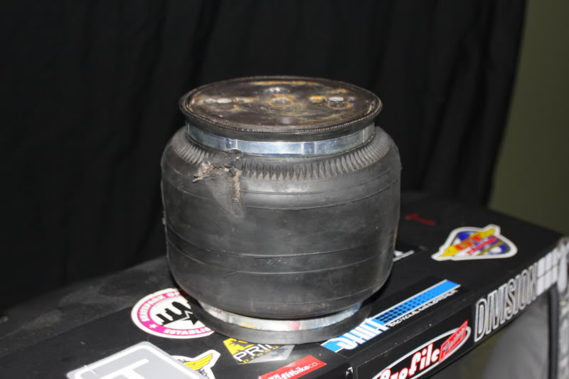

Well since the bags just replaced the springs, I believe there isnt much to worry about. Other than having some part of the car rub on it like the wheel/tire or a bolt on like a shock or something. It would suck for this to happen
edit: i was beat by a/the builder

they do sell smaller bags which would work nicely on the back of the fits instead of using those big bags which are more for heavier gm style cars...

You would have to be trying to blow a bag if you hit something. I'm talking trying hard. Unless of course you have a really crappy bag job.

Yeah the picture I posted was off an install for a GTI. I believe that its the smallest bag that universal makes in that shape. That one happened to rub one the shock bolt cause it much closer on GTIs.
