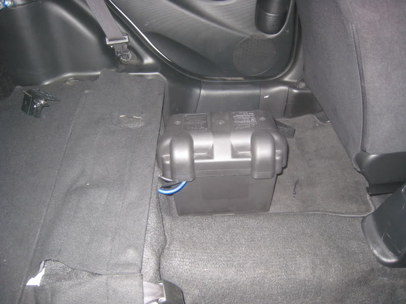

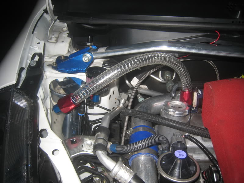

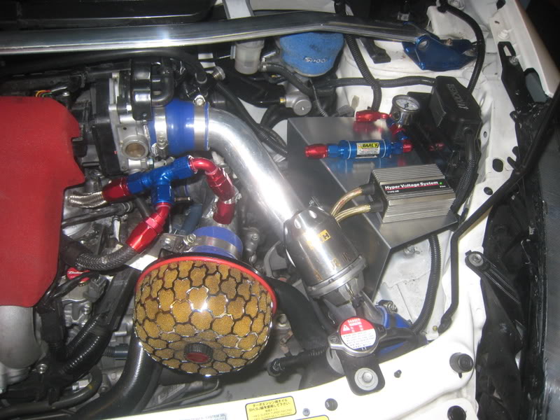

well i wanted to clean things up under the hood and one of the easiest ways to do that was wire lume all the wires and relocate the battery to the back. i also wanted to give the engine bay a lil more bling so i got a high flow fuel filter and a fuel pressure gauge, they dident have enough braided line in stock for the fuel lines but im getting it all monday. im taking all the rubber factory hose out and replacing it with -6 AN line from the fire wall to the fuel rail. i had the mount for it all made at a local machine shop, along with the catch can i think the fits ugly engine bay is really turning around for the better.

i have been thinking about relocating my battery to the little cubby in the back. i also have the odyssey pc680 batt.

ahh thats really nice! btw how did you paint your valve cover? did you use the winkle paint first then use a red paint? i was wanting to do that... just wondering how you did yours =) but overall clean engine bay =) i dont like it... i LOVE it! =D

lol thanks mang i love it too. and the paint is red wrinkle paint the company is VHT they have yellow blue red and black and its all high heat. very good stuff about 7 bux a can. the best way i found to do it is one light coat then a really thick coat u get nice high wrinkles.
