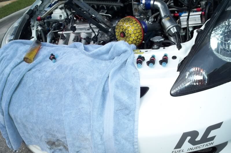

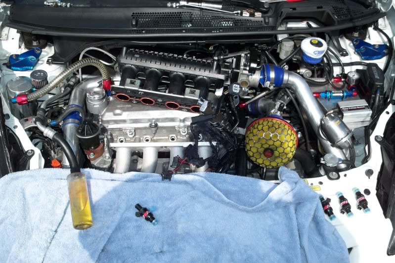

got to JAPTRIX in west palm, and did a quick injector change in the parking lot to RC 550cc injectors

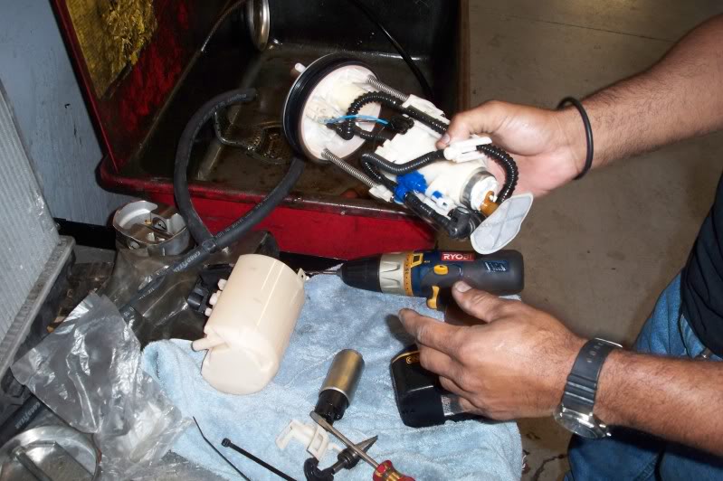

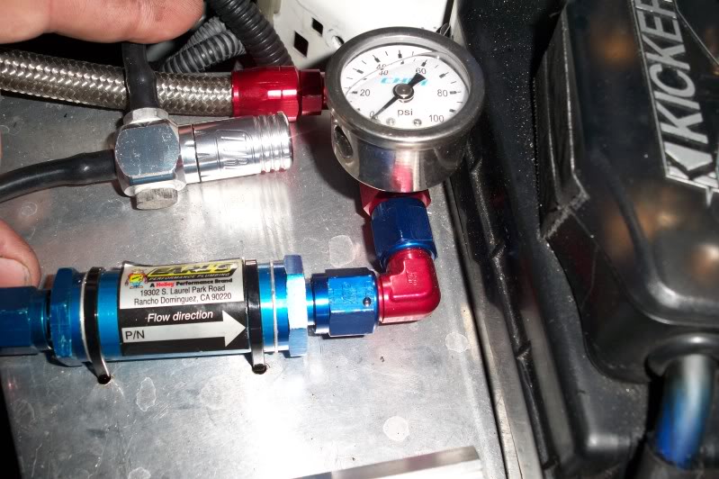

before the car went on the dyno we installed a Walbro 255 fuel pump

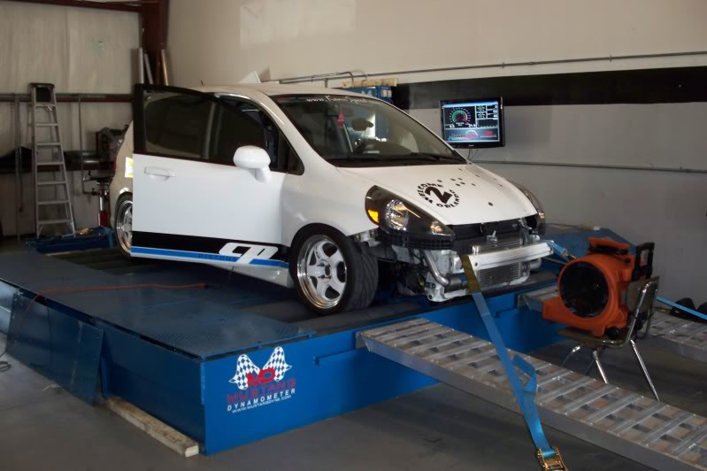

ok strapped on the dyno ready for fun

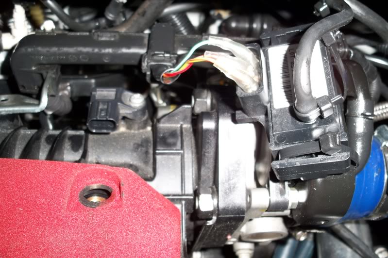

well the MBC is all well and good but there is no way to tune after 9.6 LBS of boost because of the MAP sensor. so i called around and found a local shop that had a 3 BAR MAP sensor (1 BAR=14.5 PSI) wired it up and installed it

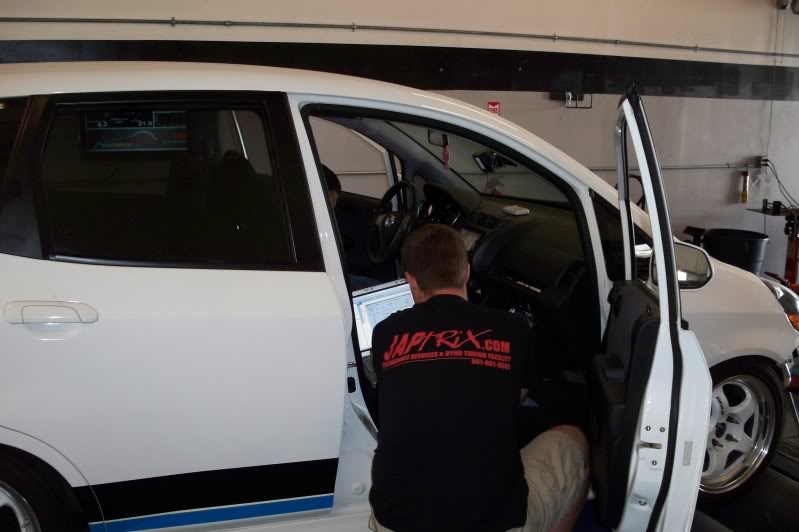

here is where the fun starts, the fcon did not see the new map sensor because it uses the millivolt system. were as the honda and Fcon uses a 5 volt reference and modifies it to changes in manifold pressure. after about 3 hours on the dyno we had to start all over again, the guys at Japtrix spent another 5 hours re-writing the whole tune from scratch converting all the MV into V reading.

so long story short after a long day i only got one vid of the car on 10 LBS only going to like 4500 rpm lol look at the numbers still!!!!!! pretty much the boost levels i was already at but now on low compression pistons. you also have to remember that a mustang dyno reads very very low a lot lower then a dyno jet.
i still was not overly happy with the numbers on 20 lbs because the turbo was falling off sooner then expected. lets just say the final numbers were well into the 200hp and tq range ill get a bigger turbo soon enough. then ill expect BIG BIG numbers. the good thing now is that the AF's are very very very good and it pulls harder then ever. and the motor is sooooo solid
