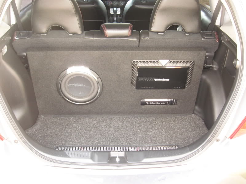

Sorry to leave you hanging Felix.....
My set up is pretty basic
Alpine single din deck
RF Power 6.5 components in front doors
RF Power 6.5 coax's in rear doors
RF Punch P3 Shallow Mount 10" sub (in .5 cu ft sealed enclosure)
RF Power T600-4 amp (Ch 1&2 front speakers, Ch 3&4 bridged to sub)
RF 2 farad digital Cap
RF Deadskin sound deadening mat (80 sq ft)
RF 4 AWG wiring kit
Optima D51R Yellow Top

I want my seats wrapped in leather with red stitching
I like your set up clean and simple. I have a 12" kicker with a rockford amp. Sounds great but my trunk is boring I wish i had a nice looking box like yours.

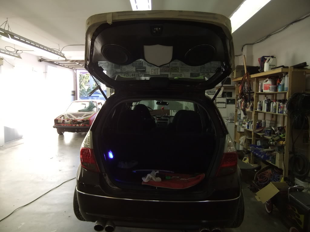

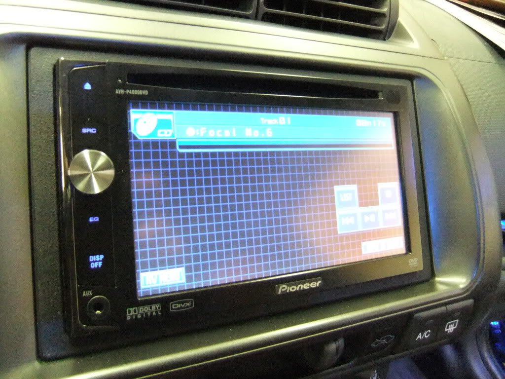

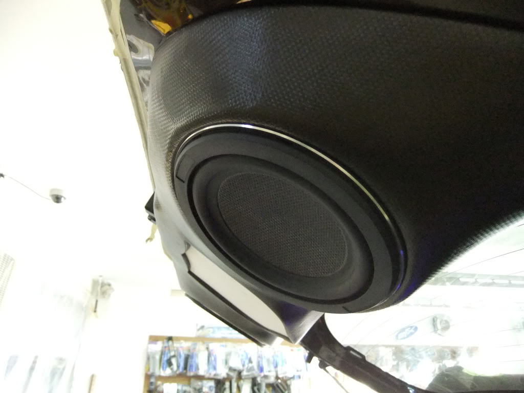

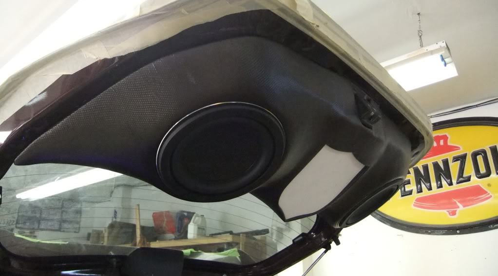

My First Ever audio system done by BPG Tuning
requirements:
1) build time
3 weeks
2) Price to complete
$1600 for parts ...may be $1500 for labour
3) Product used
Kenwood and JL
4) comments
dunno yet..it's not finish
5) upgrades
front speakers
here are pictures

holy crap this is the sickest sub setup ive ever seen, i know its not done yet but that is completely functional, i have a huge ported box in my trunk a and this wuld b perfect but i dont have that much money to spend on making it work. great job felixy69!

Only concern I have is closing the trunk and such banging those subs around you know. And vibrations from the license plate are going to be crazy! It's a sick set up though just not sure if it's the best route to go.
A monitor in the middle would be nice. and be very careful something can puncture those things when closing the trunk with just a little bit of pressure.

whats in the middle is gonna be a chromed or plexi glass crest...badge type of design.
my problem now is the struts are too weak to hold it up... .. what should i replace it with ?

tein struts for the ultimate baller status. but im not sure what length you would need.

i don't care abpit status...i need some thing that works
