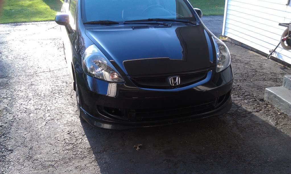

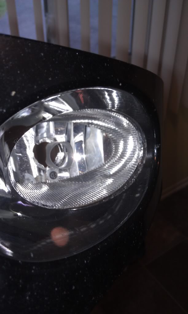

Another low-budget DIY project for my Fit since painting the wheels. The glass fog light lenses were busted, one with an actual rock hole and the other cracked all the way across. Nothing amazingly special, but a nice little project to get out in the nice weather/garage.
So surprised how simple the fog light shrouds came off once I found the screw lol
Pulled Shrouds -

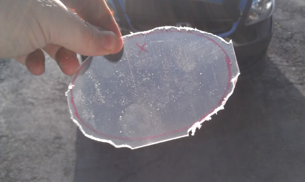

Busted rest of glass out, and got rough cutting Lexan -

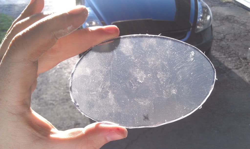

Finish cutting/Sanding is a bit of a PITA with dust and melting plexiglass...-

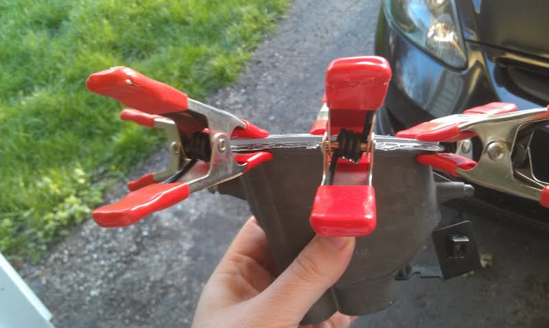

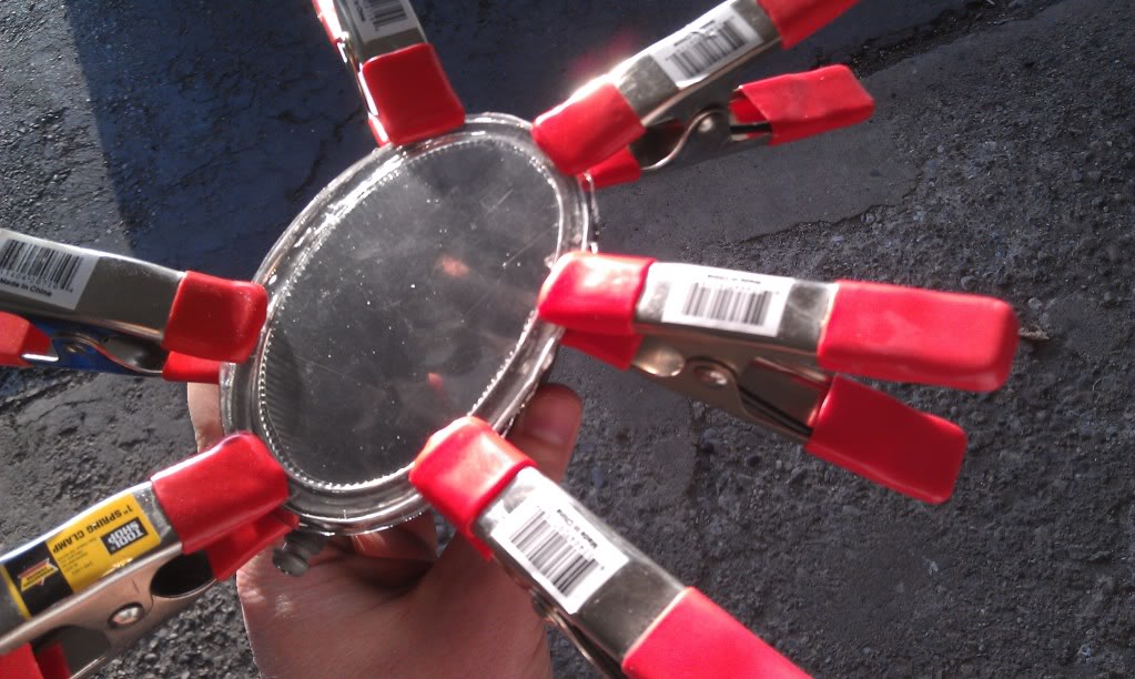

Finished lenses glued and clamped to housing to get curvature, used a clear glass caulk -

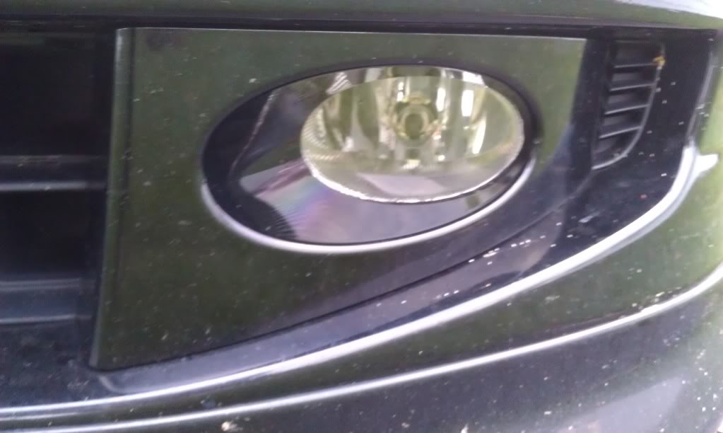

Plastic cover removed from Lexan and re-installed in shroud -

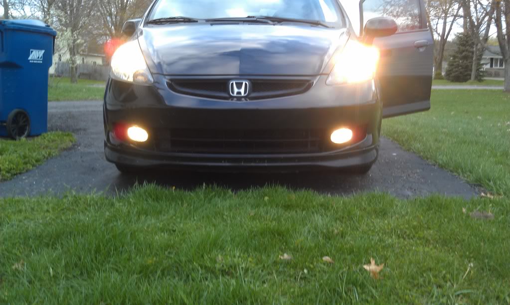

Back on car after 2 days (glue drying time with clamps) -
