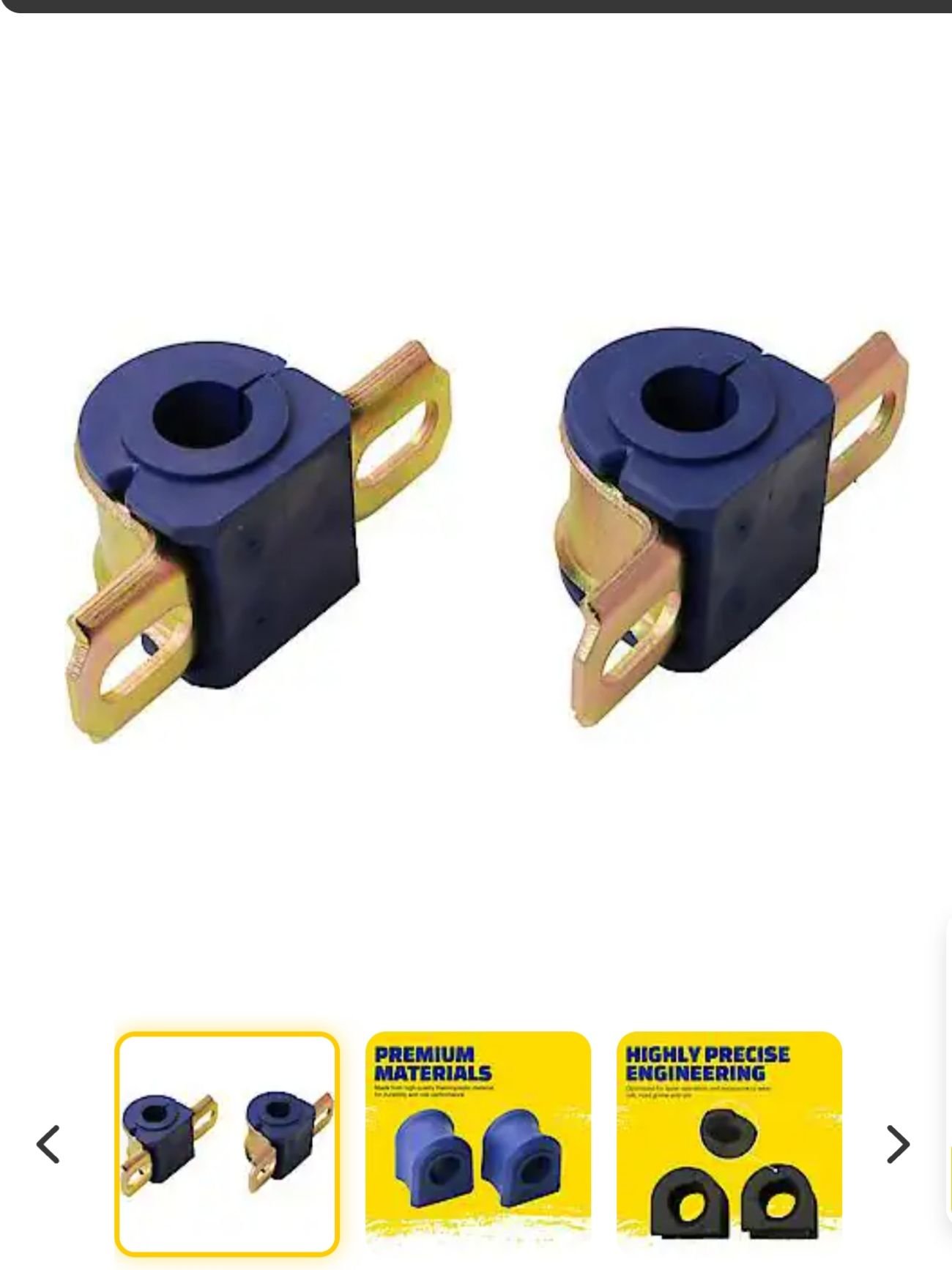

OK, I can't find anyone that sells the Cusco bushings separately.
Should I buy something like the Honda Pilot bushings that look like they have the same profile as the stock Fit ones?
Or should I just buy some universal ones that come with their own bracket?
