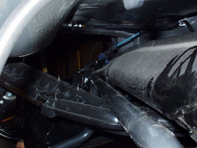

Installed!!!
Just put them on last night. Installation was not bad at all, just hot in my garage. I posted some pics. You can see where the bar is above the exhaust and gas pipe. Only I didn't like was when putting the springs back on, it was pushing down on the gas pipe. Didn't hurt anything, but didn't like how it looked when I was pushing down on the rear arm. Did a test drive and just like the others it was a world of a difference and I am on stock springs. Enjoy the pics I think you can figure it out.
Picasa Web Albums - Paul - Fit Project v...
You can see here with the bar bolted on, it is resting on the gas pipe.
