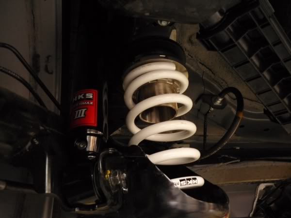

Just got done installing HKS Hypermax coilovers. I love them!
Here is some of its features:
Hiper Linear Piston – Linear progression piston adjusts oil passages for precise stroke management resulting in smoother valve movements. As piston speed increases, dampening rate linearly increases.
- Strengthened rubber upper mounts – enhanced durability
- Monotube design
- Shock-body length adjustable (most applications)
- 65mm diameter springs – Cold wound and manufactured in-house at HKS to ensure quality and consistency
- Stainless lock nut & ride height adjuster – feature anti-rust & corrosion characteristics for enhanced durability.
- 30-way adjustable dampening
- Hard chrome-plated cylinder shaft
- Non-electrolysis Nickel plated shock bodies provide durability in severe weather conditions.
- Pillowball upper mounts optional on certain applications
- Dustboots standard
- 1 year limited warranty

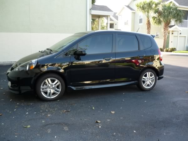

Before:

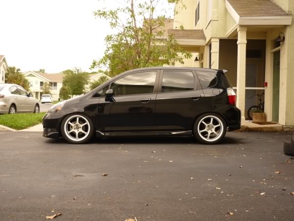

After:Name:  after.jpg

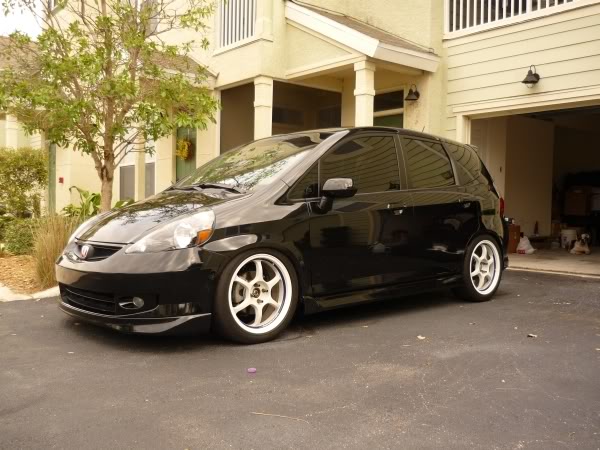

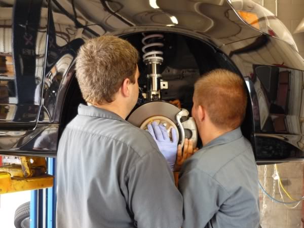

Looks awesome! What are your wheel specs? Any problems w/ rubbing?

As far as Rubbing...The after pics are taken with a new pair of advans I just got. I put them on to see how they would fit. No modification are needed for the rear but the front is rubbing the fender. I will either have to buy smaller tires, do fender modificaion, or raise the car....and I don't want to raise it. The front of the car can actually be lowered even more. With the stock wheels, the front tucks a little bit.

ooh that looks good. your wheel wells/calipers/rotors/rear spring perch look so much cleaner than mine.
