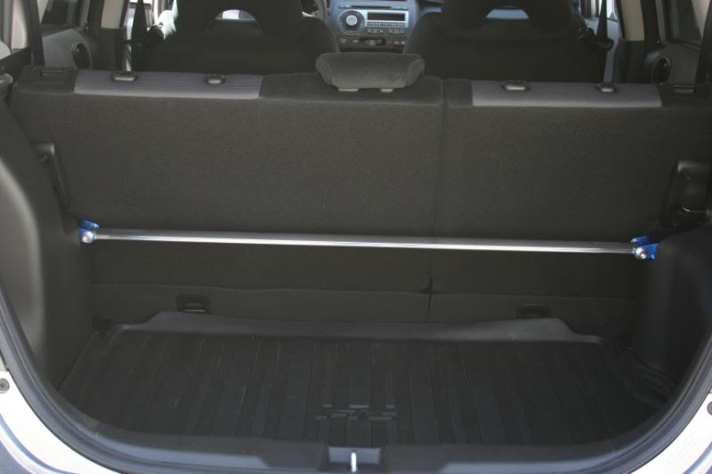

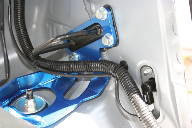

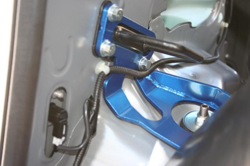

I installed it w/o removing the side panels. Just loosened them and held them back while installing everything. Removing the side panels would make it easier but then you have to unbolt the rear seatbelts.
Not hard at all.
Tools needed was 17mm and 12mm socket/wrench.
Large allen head (not sure on the size but bigger then 1/4) Got lucky and was able to borrow this from work.
Panel popping tool or pair of plier.
Screwdriver
Some pics of the install.

Seat fully reclined in the last pic. If you want to put the cover back on then they need to be trim. I just left them off. THe side panels don't have to be trim at all. Bar might get in the way if loading large objects but what rear stb doesn't do that. I rarely load large object so no biggie.
