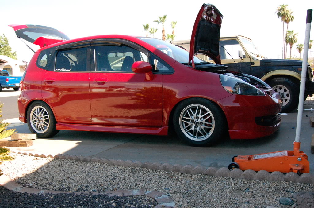

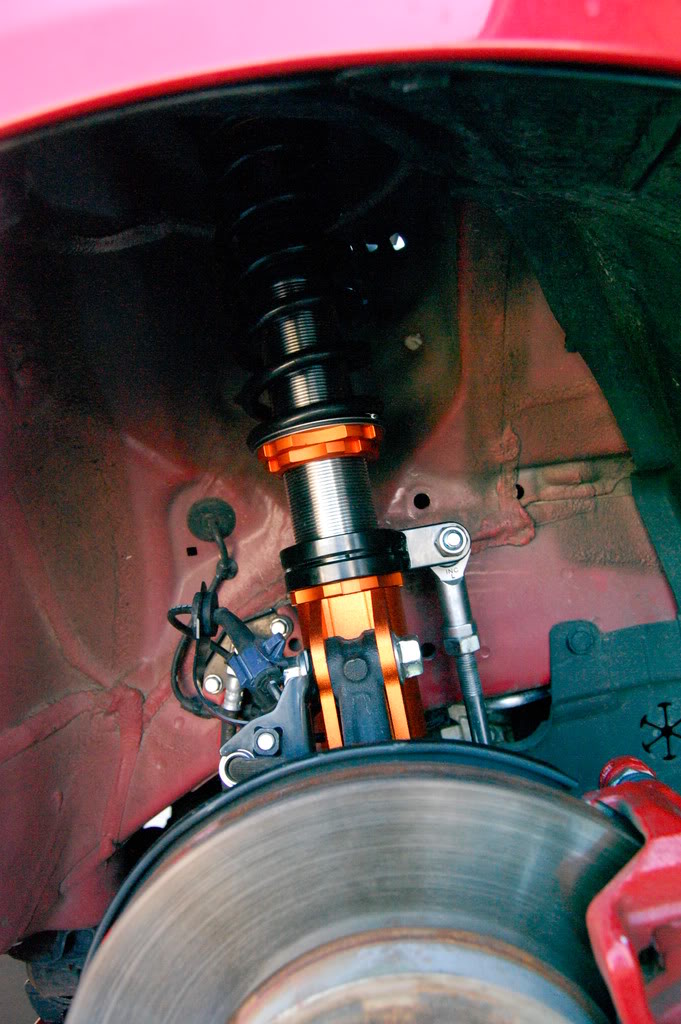

Im gonna start off with LOL because I know Im missing something. No instructions at all on how to do it so help me out guys. What am I doing wrong for the strut piston to shoot up this high on the strut tower

this is my ride height

LOL pics of the coilover under the fender?

you have to take the top hats off the stock ones and put them on the aftermarket ones.
+1
how dare you say "+1" and not give me rep!
I wuv you c_mack9! I was hoping you would post on here, I thought thats what it was, thanks bro

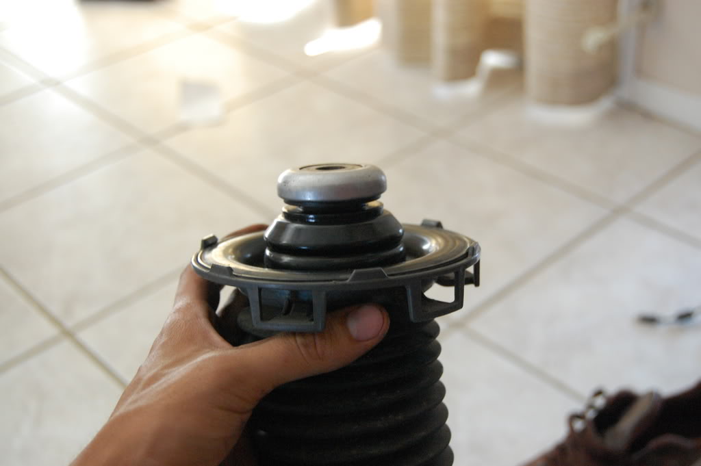

cool, one more ? lol
only need this correct?
and not all this?
Old Jul 6, 2008 | 08:42 PM
c_mack9's Avatar
Posts: 919
From: Paducah KY usa
nope you need all that crap. not the dust cover though, leave that out.
