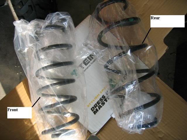

is this the right way Name:  FitSprings-2.jpg

the less coil is front, more coil rear. atleast with my eibach and stockers.
i think you have yours backwards

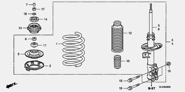

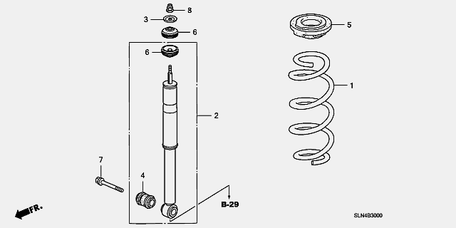

hmmm... i took a look at my rear springs and it looks like the more coil is in the rear. by looking at the picture from majestic honda it looks like the more coil goes in the front
rear
i should fully inspect it though cause i looked at the while the car is still sitting on the ground instead of lifted. so i have to make time to check it out.

ya more coils in the front i still have the stock suspension and the ones in the rear are fatter and thats the way you have it.
