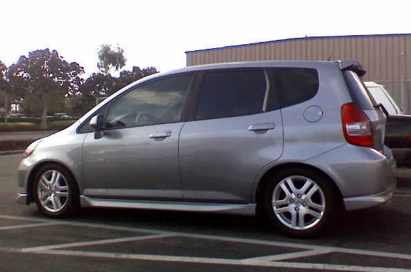

Vogtland Springs
I just put on my Vogtlands and the drop in the rear was supposed to be 1.4"
It's hard to tell, but I can't get two fingers between the tire and wheel well. Of course, mine were used so they were already broken in.

^ those look a lot loewr than the OP's.
i really have no clue why the springs would cause the rear to be that high.
