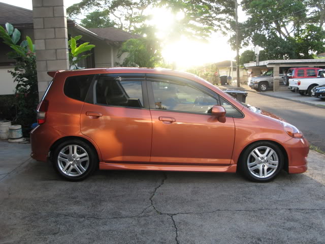

here's a pic... (FINALLY!)
installation wasnt that hard. spring compressor made the job easier and safer. also, becareful when removing the stock struts because the axle might pop out. if it does, then it makes it even harder.
im happy with the results!

although there might not be a height adjustment on these dampers, does it lower the car by any means AT all? or does it not change it?
i know putting some upgraded shocks in my past cars lowered it a bit.
Old Jan 12, 2009 | 03:27 PM
kingsize's Avatar
Posts: 506
From: Honolulu, HI
im not exactly sure if the new shocks are shorter but i never really noticed a difference in length.
the car is lowered because of the T1R v.2 springs. im sure you can achieve different heights/drops with other aftermarket springs.

perfect stance! i've got love for slammed honda's too, but its nice to see someone make a kit with daily driving and actually IMPROVING handling once in awhile!

looks like it should be 1/2" lower in back, but it's good. Tough choice to make
