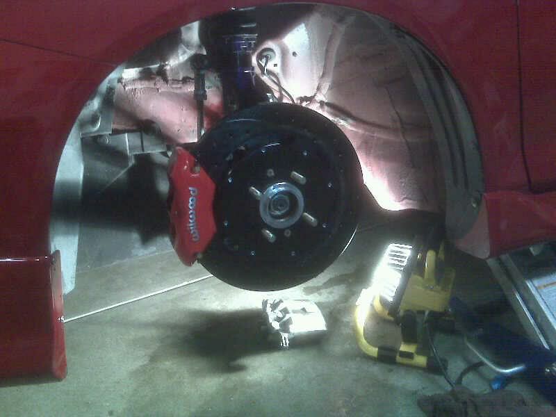

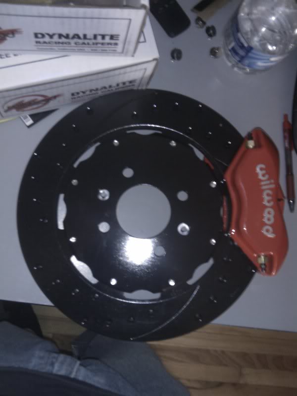

so i installed them.... bled them.... test them.... they felt too solft so i was bleeding them again and noticed 1 caliper was sqirting fluid everywhere.... ... had to take them off due to a broken bleeder screw, gonna call WilWood Monday and try to get a replacement

also i ordered Brake lines from a Civic/Integra but they dont fit, any one know who sells SS Brake lines for the fit? and if they will fit stock to WilWood Calipers?

yeah i saw the T1r's, i thought civic ones would fit so i ordered them, but they dont... the stock lines bolt up to the WilWood's so i think ill just pick up the T1R's or if i find another company....
Also since i have 3-piece BBS wheels i forgot about the inner clearence with the bolts that hold the wheel together, had to run another 5mm spacer, now im at 20mm. but i looks nice though

ill take better ones when i re install the kit
