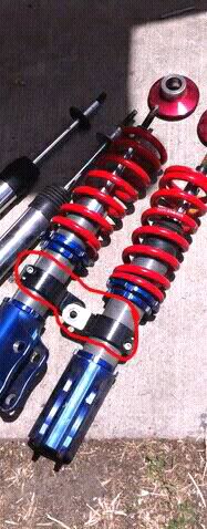

So i installed coilovers( no idea what brand) that i bought off a fellow FFer. Install wend great and i am maxed out the lowest in the rear tuckin tire=perfect. Then tje front i went as low as i could but the swaybar endlink bracket stops me from going as low as i want. Is there a solution with this setup? Adjustable endlinks ? Or i could possibly shave the bracket??? I just dont kno and need some advice. THANKS.
Here is a pic of the coilover setup. Right now on the car the black bracket is touching the locking rings for springrate.

T1R B-52s? If you are gonna go max low you can remove the lower lock ring, you won't need it anyway. That should buy you another quarter to half inch I would guess. I wouldn't recommend shaving the sway bar link tab, you don't want that thing breaking under stress. There are a couple of companies that sell adjustable endlinks, folks on here seem to like the Powergrid brand. HTH

Thanks grt. Great idea.

remove the swaybar endlink brackets. who needs a nice handling car, anyway

Yikes no endlinks that sketchy.

Matt, the always helpful LOL No front swaybar at all would be SCARY if you weren't ready for it. I'm actually trying to think of what it would do now, Understeer like crazy most likely.....

Nothing sketchy about no endlinks. While the swaybar does improve handling, it's not going to hurt anything not having one. If you want to go lower just take the endlinks off. I've gone without them for months when mine broke.

my pro c coilovers came with adjustable endlinks. the center part fell off when i was driving, i guess.
