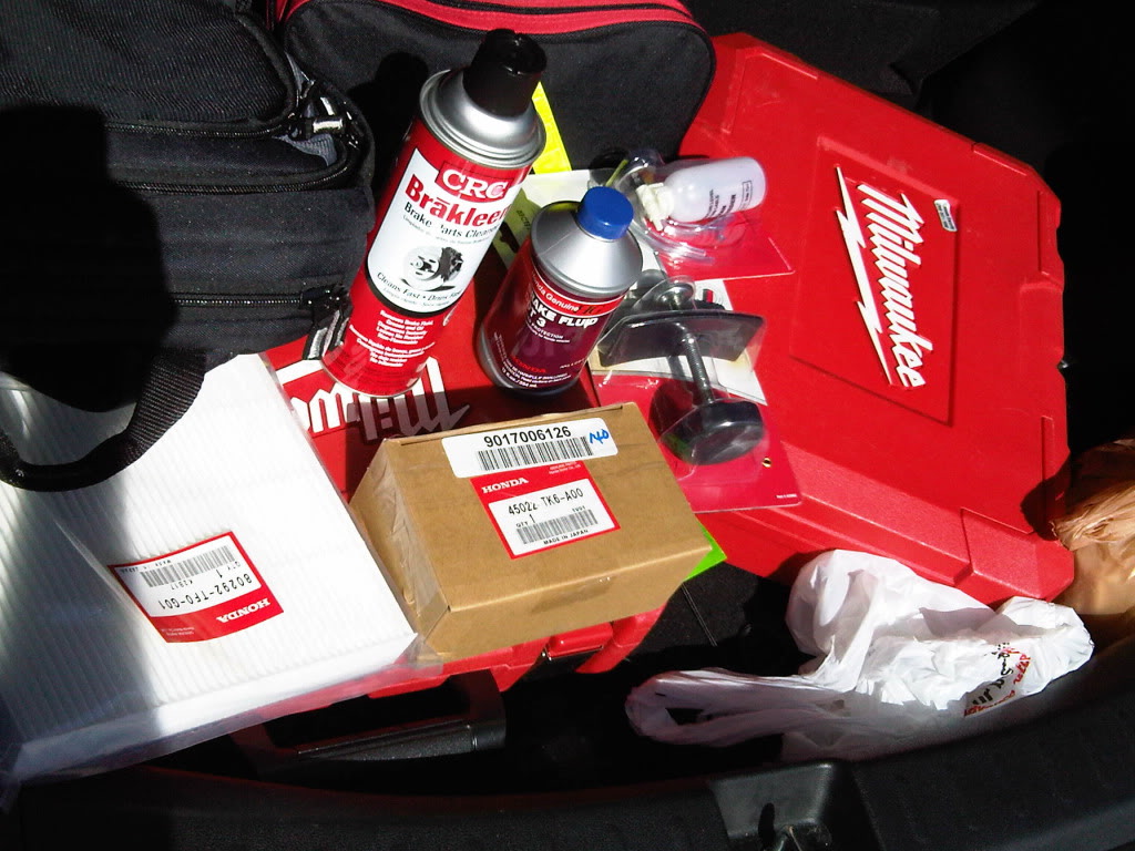

Exuse the mess. Stopped at Honda after the parts store to pick up the rest of the items. I will most likely tackel this later today.

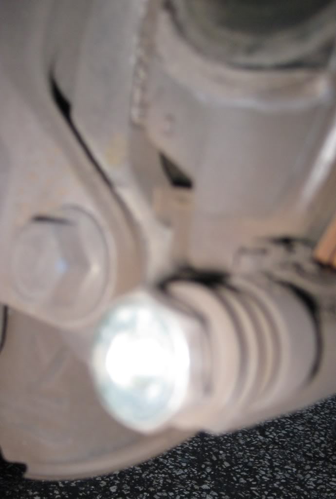

Removing this bolt (12mm I think), gave me direct access to the pads.

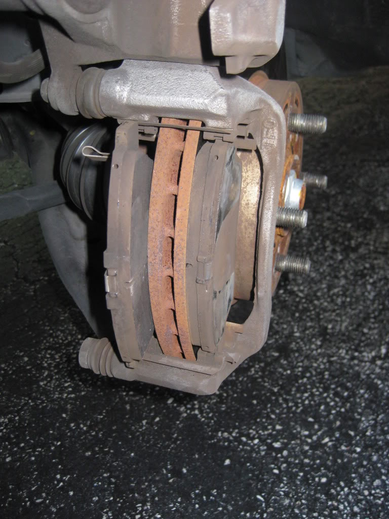

They just slide on and off very easily.

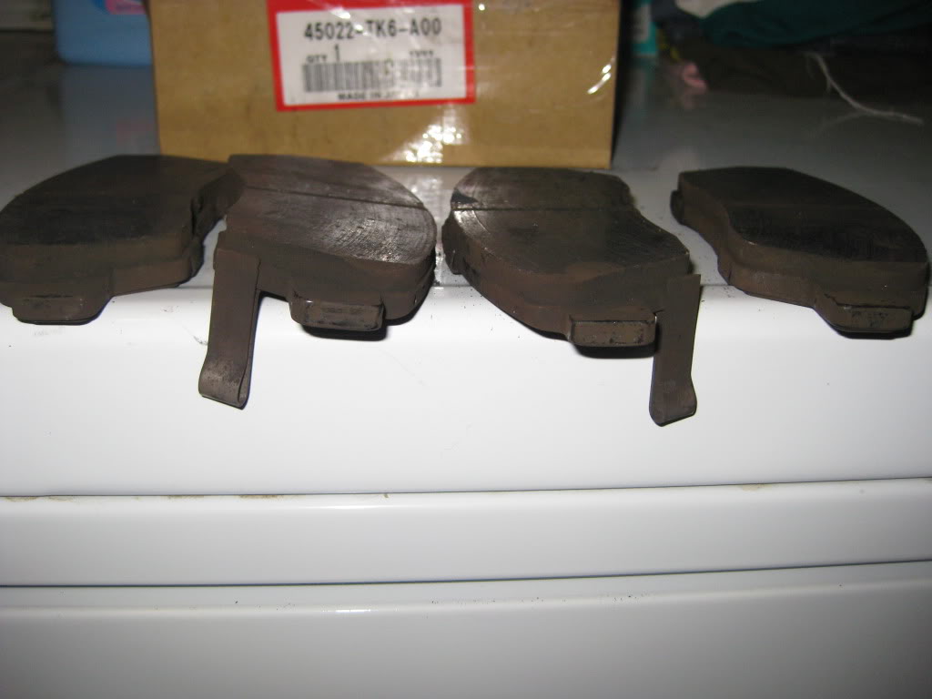

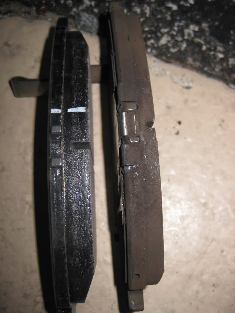

At 45k miles, my pads still had heaps of life left. I estimate that my highway miles and Florida's flat terrain would have allowed me around 15-20K more miles.
