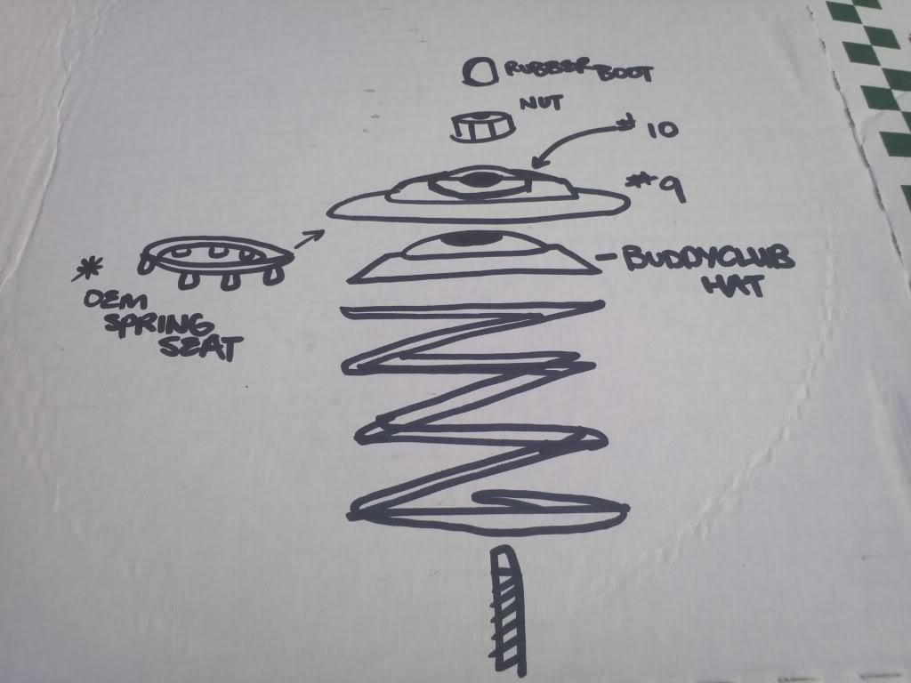

Also note: My friend and I went with the installation last night and the only part he forgot to add in was #s 9 so that might be causing the noise at the slow/crawling turn speeds. Poop. So yeah time to make some adjustments.
Does #9 sit under? Since I know # 10 sits on top. Thanks a bunch joey!

Yes between the spring and oem top hat. Check all collars then then nut on top has a torque spec of 25flbs if too tight it will cause the spring to bind. Sounds like horror movie door but slower.a popping sound on dips or bumps top nut too loose. If everything is tight try and remove the top nuts an turn lock to lock your sound will improve or worsen giving you a place to start

Old Sep 9, 2012 | 08:11 PM
joey_fits's Avatar
Posts: 461
From: sacramento california
I'm at work now ill check later. Hopefully this makes some sense
Old Sep 9, 2012 | 09:13 PM
Oh, That Guy.'s Avatar
Joined: Oct 2011
Posts: 43
From: Texas
very helpful! why is the oem spring seat have an asterisk? optional or removed from? XD i took it off already from the oem spring seat and its just sitting in my car til i make the time to put it in. hopefully the second round my axles won't need to be popped back in when i take them off haha.
