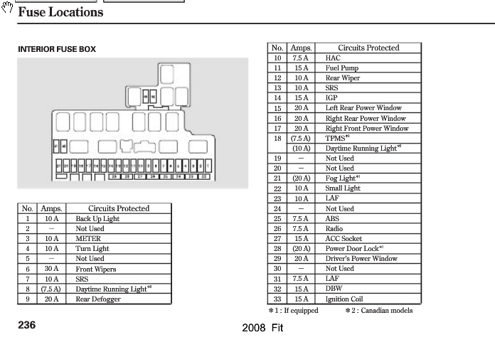

I believe you can disable ABS by pulling fuse 25.
Here's a diagram from the owners manual:

Ikutoisahobo is right. I was also told to disconnect the clip from the ABS unit as well. I still haven't tried this yet for the track. As soon as I get the car I plan to see the difference.

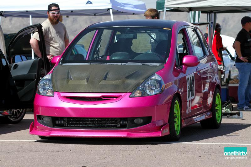

I have what started as a base gd.
Anyways back on track. Op make sure your tires have plenty of tread. I know you said it happens in the snow. I haven't drove an abs car in snow but I bet it's gotta be annoying. Any who like these guys said you could pull the fuse or unplug the module either one should work. The module connector is pretty easy to get to. I did this on my race car. My sure that you understand what wheel slip feels like because tires don't always make noise in case of panic stops.
