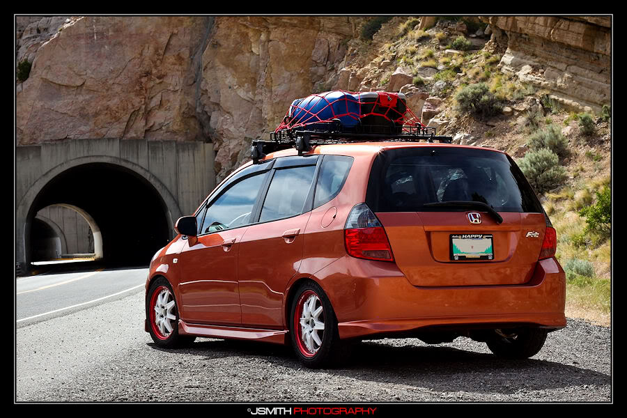

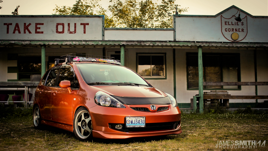

In 2007, I was "fortunate" enough to purchase a 2007 Honda Fit Sport. Since then I've been through some various suspension setups including stock, Eibach, and currently Buddy Club N+.
Needless to say, I haven't been impressed with any of them. The Eibach's blew the factory shocks, even though they according to Eibach were designed for them, and the Buddy Club N+ ride extremely rough for the soft spring rates they come with.... not to mention the fact that both rear shocks have already blown out prematurely, and now Buddy Club wants $500 for two replacement shocks on a $1200 system.
Given this, I'm now considering replacing the entire suspension setup once again, and would appreciate some feedback. I'm also quite content with the ride height on the Eibach Sportlines, but wouldn't be opposed to something ride height adjustable, only more comfortable than the horrible quality of the Buddy Club N+.
Eibach Sportlines
Buddy Club N+
