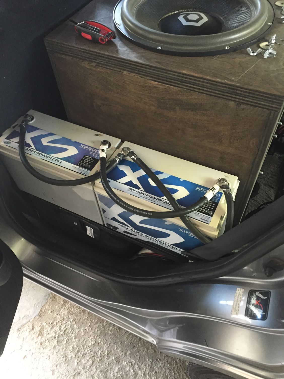

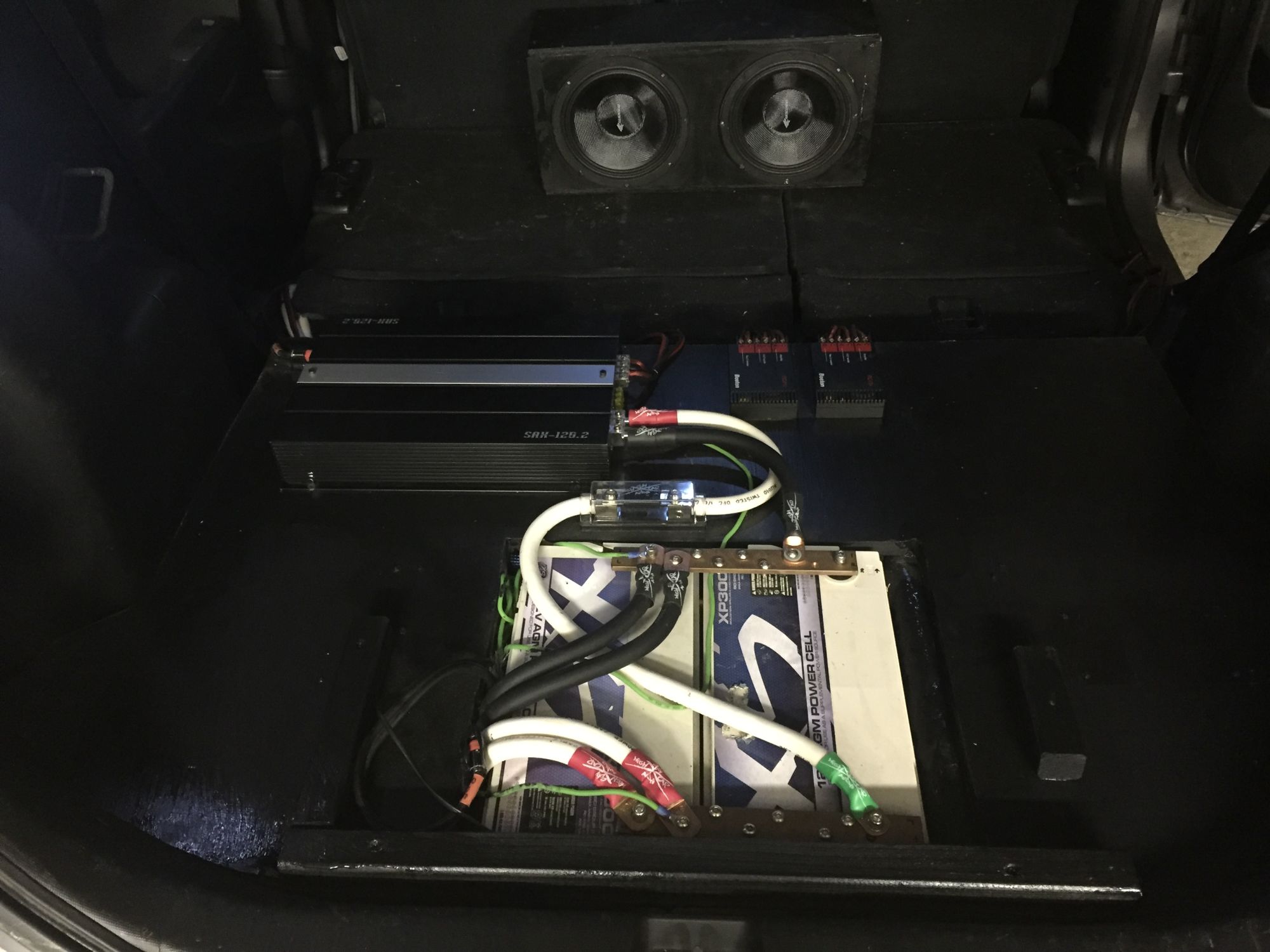

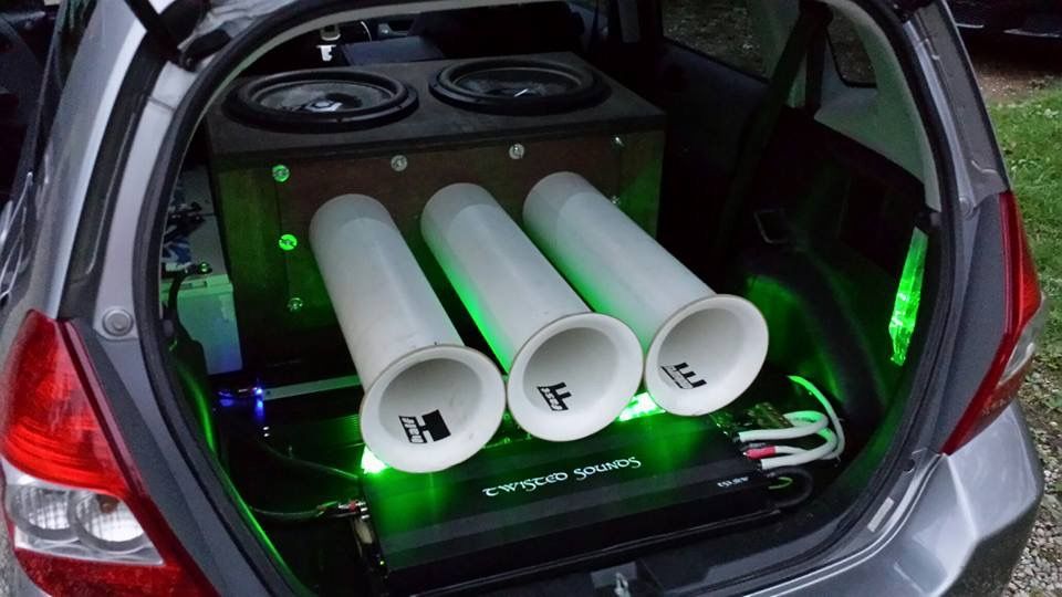

I have a lot of weight in the back of my fit, probably about 600 extra pounds of stereo equipment, (mainly 5 group 31 batteries!) I have 16" rims and they are tucking in the back with everything in, are there any companies that make heavy duty springs or helper bags for fits? Anybody else have this issue? I've already had to upgrade the brakes because of the weight

Attached Thumbnails I need stiffer springs or helper bags, who makes em?-80-image_2c2f940a5d9ed79634a87ebf23d4f3e59106fac1.jpeg   I need stiffer springs or helper bags, who makes em?-80-image_5dc8a5ad6eaba7cd87e05b8326aae185ae1c78fc.jpeg   I need stiffer springs or helper bags, who makes em?-80-image_d8c82dca7ddfd2c66b771de75f648bd21e928656.jpeg

By the way, your batteries are not connected in a balanced manner, so won't charge and discharge precisely equally. Over time, this can lead to extra battery capacity reduction and other undesirable effects. Perhaps in your situation it's more a theoretical difficulty than an actual one (as your battery interconnections are pretty low impedance).
